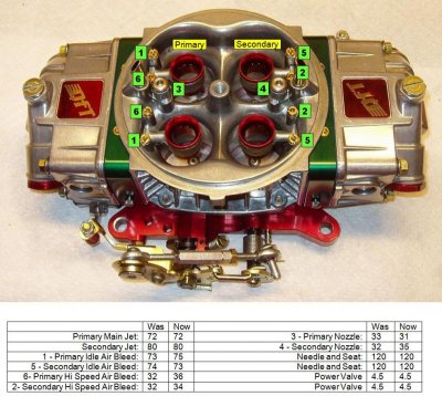

Devin, if you get the quick fuel you will love the tuneability. Here is a log I use for mine.
They are expensive but worth it.
Thanks, that is why I want one.... tunability! I've done all I can with mine and feel it needs some air bleed tuning which it doesn't offer so instead of farting around I'll buy exactly what I need and be done with it.
