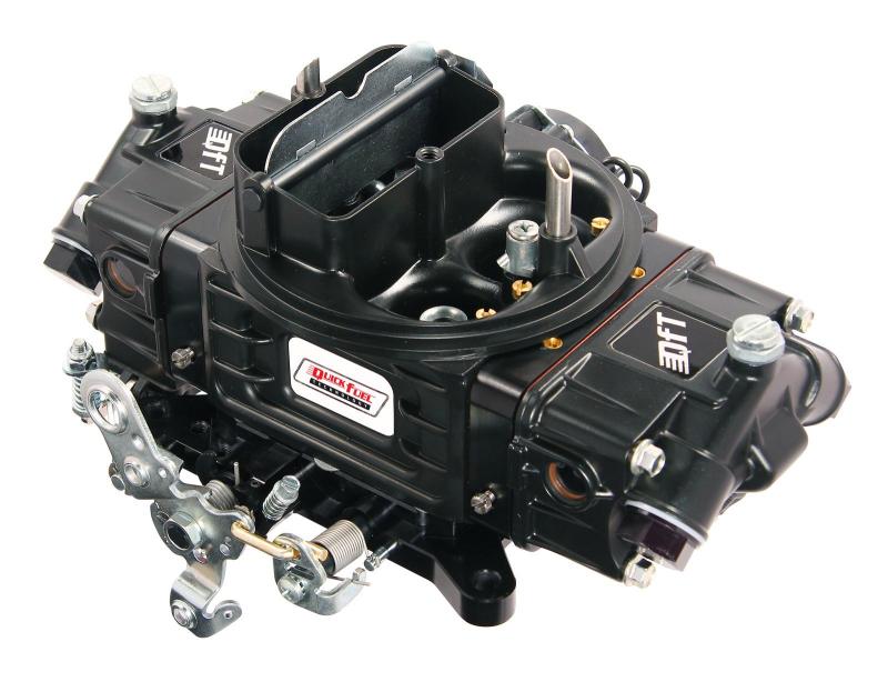

      Actually they do, I'm thinking about this one.
      I would love to go without a choke but after running a Demon without a choke on one of my other cars I swore I'd never do it again, there were times it took 2 people to start it with one choking it so that's out.
      I will add that my motor doesn't seem to like being choked though, starts great but runs like shit until the choke disengages which is set to turn off about as quickly as possible.
