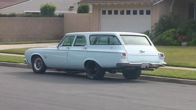

Took my 64 Savoy Wagon over to the scales today to get it weighed.
4120 lbs with me in it (245lbs) at race weight so 3880 without driver
And it has 2260 lbs on the rear axle, that is 54.8%. No wonder the wagon's hook great!!
The combo is a pretty basic 440 forged crannk, LY rods, Icon pistons with 10.6:1 compression, Stealth Aluminum Heads with some minimal clean up and a port match to the intake no idea what they flow, Hughes Mechanical Cam .564/.576 242/246 @.050 @109lsa, Headman Headers, Performer RPM, Holley 800, 727 with a 3200 rpm stall, RMVB, Dana 60 4.10 Posi, bastard pack wagon main leaf SS springs, with a clamp on each side.. Hoosier Quick Time Pro's and full exhaust. Wilwood street disc's, Mopar Aluminium Master Cylinder, Aluminum water pump and housing, full interior, everything works... wipers, lights, heater, dome light...

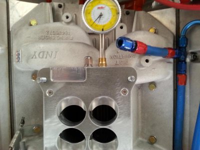

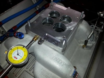

plate open.jpgplate part closed.jpgI think all of Wallace Calcs are based on REAR WHEEL HP....not flywheel Dyno type HP...so 471REAR WHEEL HP is what EngineDyno HP PROBABLY well over 550 or so...I am not sure. The great thing is....if it runs FASTER than 12.00 then buy an ET GENIE (like I have) to slow it down to 12 flat....then 100% of the guys dialed in at slower than 12 flat will have to LEAVE FIRST....so u can watch them redlite...best position to be in.
The ET Genie is a restrictor plate that "slides" closing off the air/fuel delivery to make the motor seem smaller. You set it with a dial indicator. After a few trial settings you can get it dialed in almost perfect to the ET you want to run....you floor the accelerator like normal and run it full blast only the ET Genie is slowing you down to the desired ET.
I dont mean to hi-jack the thread but I thought this would be interesting to Mr. LongRoof....and Good Luck at your first Test & Tune of the Year.
