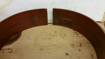

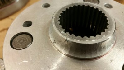

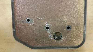

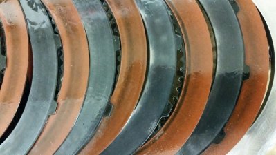

As promised. Rear clutch , front clutch, band all look perfect. 225 passes in 900HP 3350lb car. it uses the stock rear clutches and reverse band. The rear clutch is always applied immediately when any forward gear is selected so it is not subjected to slippage unless you have a piston or hard part failure. I use Alto red friction material for the KD band and front clutch. Same fluid 130 passes with aluminum drum. no band adjustments, band was still at 1.5 turns when disassembled. Front planet is cracked so it'll get that and a new filter. Check it again at the end of 2017.
