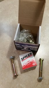

Picked up the k from machine shop today. Also got my first delivery of parts! Pinion yoke, pinion seal and rear spring bolts. Now I can prep the dana for sandblasting.

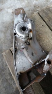

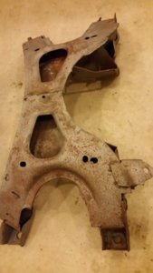

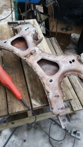

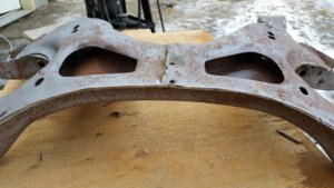

I had the whole day today to work on the charger so I decided to start reinforcing the k. I have to do this work outside because i dont want smoke and metal dust on the other cars. The weather was nice and mild so I got the welder outside and ready to go. Just to find out i didnt have any gas left. I must have left the valve slightly open last time i used it.:BangHead: So I called around and the closest place i could find to refill my bottle on a Saturday was in brampton 1 hour away. Bit the bullet and went to fill. Thank god at least 1 place was open.
I cut some of the lip off the k the even it up. Some places were over lapped. Also found a few crappy factory welds.
Started by welding the edges. I welded 1-2 sections and kept moving around to different spots to keep it from warping. This was alot of welding. Good thing this car wont be for drag racing i must have added 2 pounds of weld!

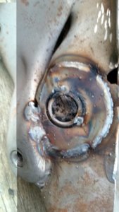

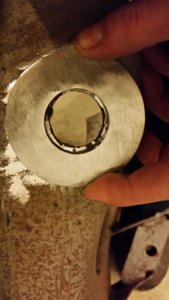

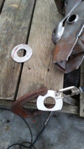

I bought some washers to strengthen the lca pivots. All i could find was galvanized so i had to grind all of that off first. Then marked them and cut to fit

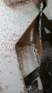

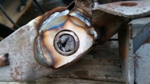

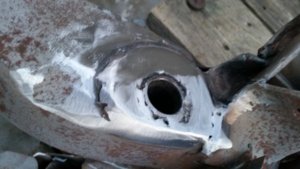

I put a wet rag in the holes before welding to keep the worst of the spatter out. Then welded them on. Welding the inside of the washer without wrecking the surface that the pivot sits on was quite difficult. Its not the prettiest weld there but i am afraid to add any more.

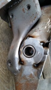

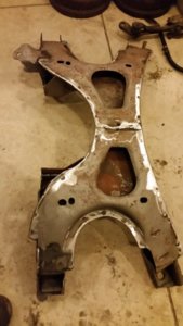

Ground down the edges and washers. Thats it for today. Hopefully i can find some time tomorrow to make templates to make the triangle shaped reinforcements.

Has anybody installed the firm feel reinforcement kit? I want to add washers to where the strut rods mount but im not sure of the size.
-Is this washer's i.d too big?
-Or should i match the hole size in the k frame?

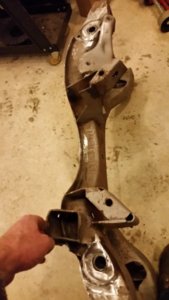

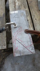

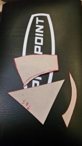

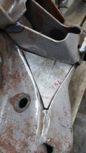

I made some cardboard templates for reinforcing the steering box. Then cut them out and welded them in. They had to be bent to fit the contours of the k frame. Its surprising how long these jobs take with only limited tools!
