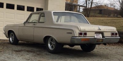

Here is a two owner 1964 330 sedan that is owned by an 86 year old friend of mine. His uncle bought it brand new, currently has just over 30,000 miles. Was a /6 automatic originally. He wanted to upgrade the drivetrain, now has 440 HP w/727 pushbutton, ‘65 rear axle with 3:73 Suregrip, dual exhaust and power disc brakes up front. I also added the 15” Mirada wheels. Interior is all original and very good condition.
To the left and right of the lisence plate are the reverse lights. The lisence plate light is above plate- which is same for all VD1-2 models.

When I did the work on this car, he wanted me to get rid of the two bumper stickers. I convinced him to leave them on. One is from McDonalds, the other is KDKA radio! (still operating) You can still listen to it on the am radio in the car. Car had power steering and manual brakes.

That is one nice Dodge! And the wheels look excellent. I was surprized to see those reverse lights. I cannot remember ever seeing those and I will chalk it up to old age and forgetfulness.
