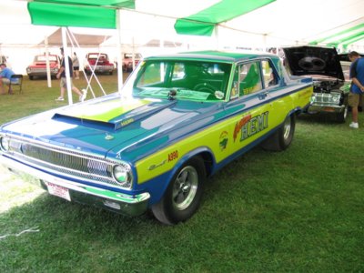

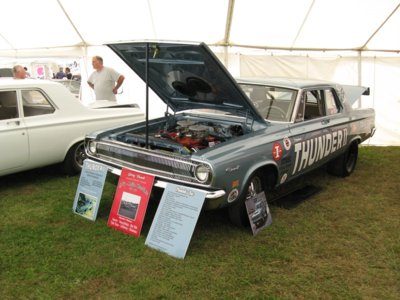

By the looks of the 2 pics you posted, the front ends don't appear to be moved forward. I really hope you get some knowing responses on this, as I am very interested in all I can learn on these also. Thanks for posting...

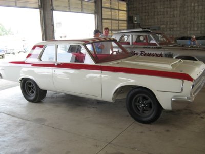

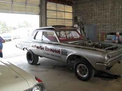

I'm pretty sure the 2% cars were '64's. Look at Hemi-itis' photos of the RAMCHARGER Dodge above (Unlettered, it's the top right photo). The K frame bolts were moved forward. The leaf spring front section was shortened and the inner fenders were rolled. I don't think they used sedan doors on hardtops...I think all the 2% cars were sedans. This I'm not positive of though.

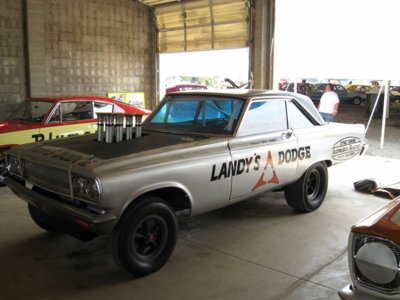

Looking at Hemi-itis's photo montage, there are a host of different cars there. The first one which is Dandy Dicks car is a bonafide 1965 10/15 AFX altered wheelbase car. The second one is Dandy Dicks 1964 A-864 Sedan SS car that was altered to a 2% stance, but also utilizing a straight axle by Dick himself. Perhaps the first of its kind.
The 3rd photo down is the Diamond. It's the Ramchargers bonafide factory 1964' 2% car. Note the front fender apron cut out to clear the front wheels.

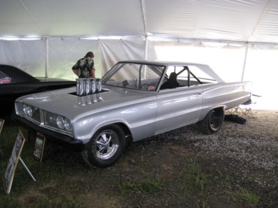

The rest are standard 1964 A-864 Sedan and 1965 A-990 sedan Hemi SS cars with the exception of the ultra modified 66' Dodge.
