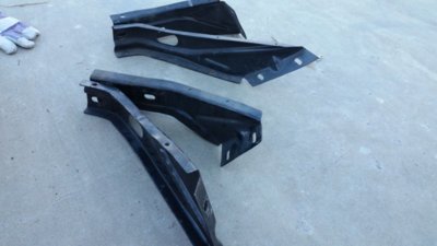

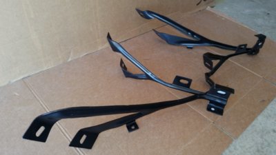

Thought you might like to see what I did, instead of making (or buying) aluminum bumper brackets....
Here are pixs of my stock steel front bumper brackets BEFORE AND AFTER I modified them to lose weight.
I lightened up my REAR bumper brackets in a similar fashion.
The last pix shows all of the metal I removed from all 4 brackets.
On the REAR brackets I actually cut away ONE HALF of the bracket...the halfs that I cut away are shown in the picture.
The modified brackets are very, very light now...probably not much more than aluminum brackets and they cost me nothing.

Wow great idea let me look at mine maybe I can go that way instead of making new ones.now do you still use the bumper bolts from the outside or do you do like malex. Thank you I can see after removing all the extra they would be pretty light and no cost is even better.

After I cut down my stock brackets I still used the stock bolts to mount the brackets to the frame but I used hardware store stainless steel Allen Head Cap Screws to mount my fiberglass bumpers to the cut down bumper brackets.
Again, after cutting them down they weight hardly nothing....

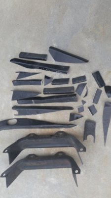

Picture is all of the stuff I cut out.
The 2 big pieces at the bottom of the picture are more than 2/3's of the rear bumper brackets that I cut off and only used less than 1/3 of the bracket which was the bottom 2 bolts out of the original 4. My cut down brackets were plenty strong for the fiberglass bumpers but they would NOT be strong enuf for steel bumpers.

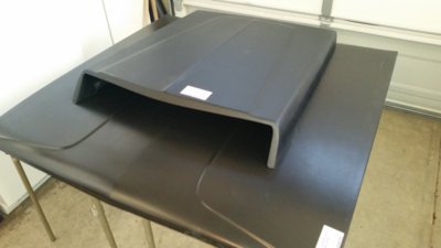

I recently bought a pin on fiberglass hood and 5" hemi scoop from Glasstech. Cant beat their quality.
