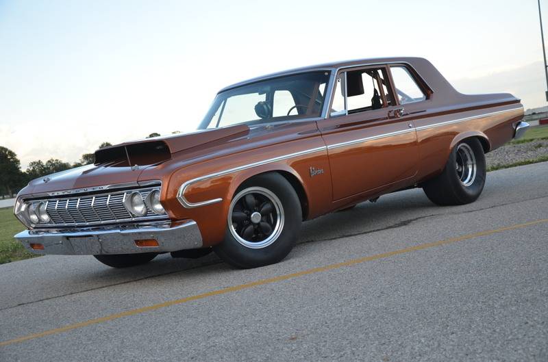

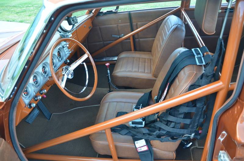

DougView attachment 638830 View attachment 638831
Doug great looking car, your right doesn't look cut up at all ! actually looks original Badass car foresure !!
Agreed! Doug had his eye on the prize when he built that gorgeous 64.

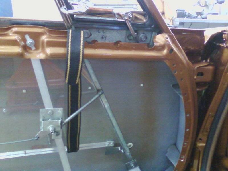

@dvw you said you removed the regulators and installed Lexan, how are you working the door glass? Sliders?

Doug, I really like the way you did the dash board.
