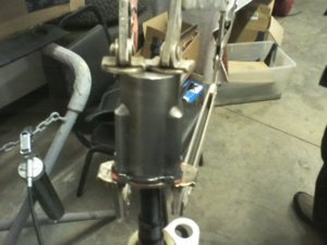

Does anybody have any advice on how to remedy this loose seal/cap on my column before I put it back in? Sorry for not having a better photo.
The rubber gasket is worn and the steel cap won't stay tight either.
I used a couple of those big fender clamps to hold the new seal and ring together while I beat the clips into submission...worked out well.
The DMT Grommet/Cap/Retainer clip seems to work.

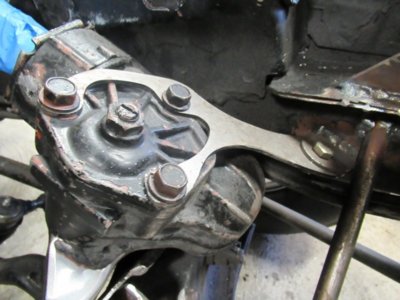

What am I looking at in the first picture? Some sort of an aftermarket brace for the top of the manual steering box?
Yes.When you have the milodon pump the motor mount/steering box mount has to be modified.When the majority of the mount is cut away this brace holds the box very nicely!!
