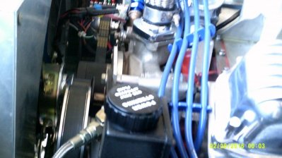

I have 2 separate 6 rib belts the one on my
{GM style} power-steering pump
for a Unisteer rack & pinion, it's tight & it needed a idler pulley,
to keep the belt off the w/p
{mounted off top right side of the w/p, w-a 1/4" 7075 flat piece of alum & proper spacer}
the other shorter belt runs my alternator, both are stand alone
& I run 2 electric fans,
1) pusher 13" 2900cfm just in case, rarely use it, but good if needed
in front of the 22" 4 core down flow Mancini Alum custom rad &
1) 16" puller 2900cfm in a custom shroud, it's tight too
& I also use a 37gpm electric water pump,
in an Mopar alum w/p housing too...
so far so good, If I was to do it again I'd do a low mount alt,
so I could add A/C where the alt. was org., no plans for A/C thou...
sorry for the crappy photography

68 RR #37 Power Steering Pump for Unisteer rack & pinion serpintine belt acc..JPG
If I had a do over it would have been moving the radiator in front of the support when I was building the car.... major pain being so cramped for space. How do you like the unisteer?
If I had to do it again, I'd do a front steer, Mustang II box &
flip flop the ball joints left to right/side to side,
fab up my own mounts & shaft etc., far more pan & header room that way
But;
I like the way it steers, great feedback, real precise, not to easy
had to do a bump-steer correction, spacing @ the ball joint ends etc.
won't turn as tight of a circle either {as OE}, no big deal it's tight enough
{It's an Omni style rear-steer box, reverse rotation so it can't go forward of the axle line}
{OE HP manifolds or S/S man. fit no problems though}
But;
Really limited on Headers {oil pans too} though too,
only out of the box headers that fit are TTI 383178C {IIRC}
no big deal I'm building a set of swept up & down the back
{kind of like like ol' S/S MW style manifolds}
but with stepped up & back 1-3/4 at the head to 1-7/8 in the bends down to 2" by the firewall
into a 4-2-1 Flowmasters Scavengers/merg collector "custom headers"
yeah now that I have a lift off 69.5 A12 pinned hood
I could have easily moved the rad in front of the core support too...
It fits but it's tights now, shoulda woulda coulda...
