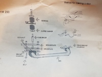

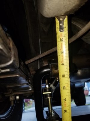

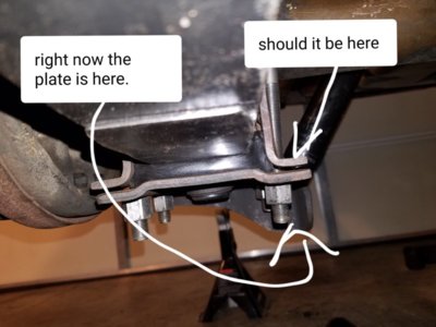

I attempted to install the rear sway bar but it's not even close to the side frame rail it's around 4 " short. I installed it per the drawing I'm not sure what to do. I emailed Dan tonight so hopefully either here or there I get and answer. I had to buy shorter bolts again they were too long for my application just like the front sway bar bolts were. I don't call because I don't get a call back.

Looks like the link is upside down.
To say the obvious, something sure don't look right!
Something is very off with those long bolts. On my stock sway bar on my 74 RR, the main horizontal section is right up under the rear axle. It shouldn't be that low to the ground.. I'm wondering if maybe the mounts without the bolts go to the leaf lower mounts by the leafsprings and the bolts go to the higher spots?
I should of took a pic of the drawing because the way it shows it is the way I have it the nut is supposed to be on top by the hanger. With it hanging down but I agree some thing is not right.

It's well below the scrub line that way, too. Even if this is the "correct" way they want it to be installed per their directions, I would not drive with it near that low.

I can't tell from your pics for sure but it appears like the bar should be above like mine since it does not have the U shape that normally goes under the 3rd member.
Your probably right all take it apart and see if that works.
