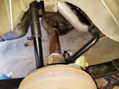

I talked to Dan st PST this morning he told me that drawings completely wrong that the midsection needs to be up on top not on the bottom that's why it's not fitting correctly which I was going to try but I want to talk to them first. Im glad we have it sorted out

Well I made some headway on it today I had to wrap it up so I wouldn't scratch it all up while feeding it thru my exhaust pipes thanks to Dan this morning for the info glad it's working out.

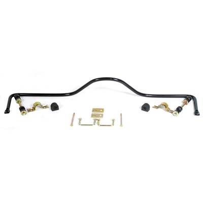

Here's a pic I found of the rear bar I ran.
The 'hump' part was over the driveshaft/diff.
You can see the 2 links provided. The grommets can be swapped to fine tune the bar. That helps tune it depending on engine size (weight up front)
A 318 would have different set up than a 440 car, for example.

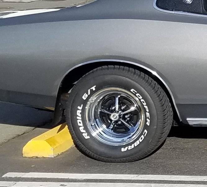

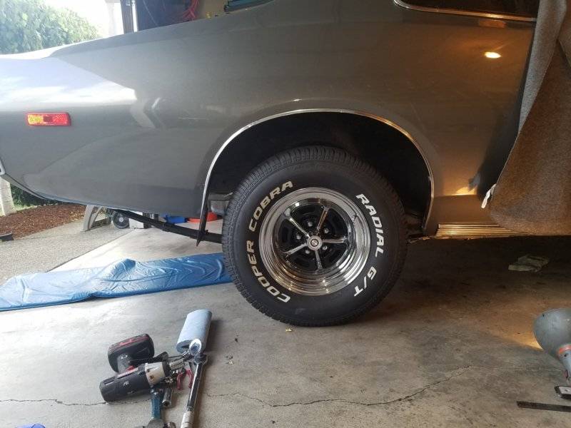

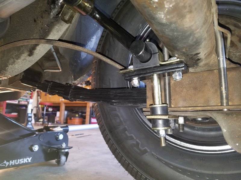

Well I ran into another issue the spacers are too long my suspension isn't even working correctly. Before rear sway bar my rear end was sitting at 1 3/4 from top of tire to center of fender well now its ast 4 1/2 . Time to shorten the spacers I had to buy shorter bolts also looks like I'll be buying even shorter bolts again . I had to do the same thing with the front.
