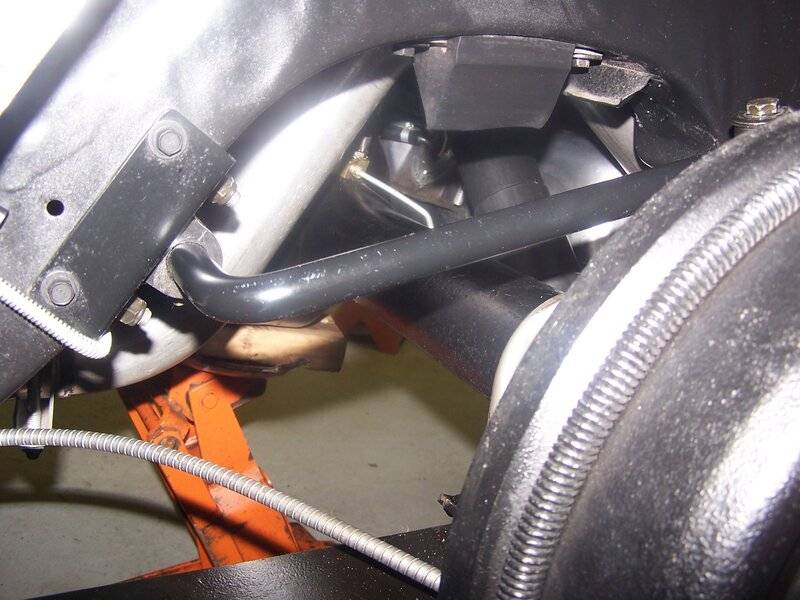

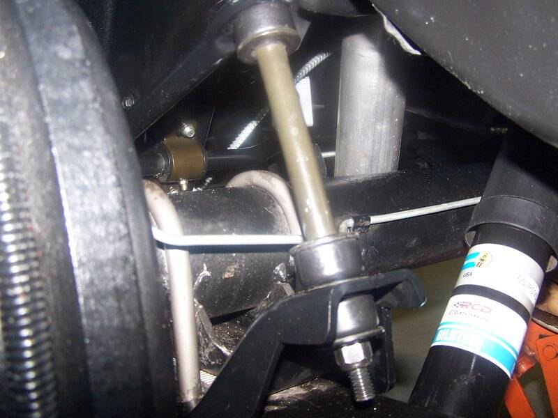

you want the car on the ground when attaching it to the frame as far as holding up the rear end I had a small jack underneath the shackle plate when installing the mid section hanger.Read it all. Sweet!!!
I learned that the car has to be supported under the axle when adding a rear bar.
Either use jack stands or a drive on hoist. You want the leafs flat.
