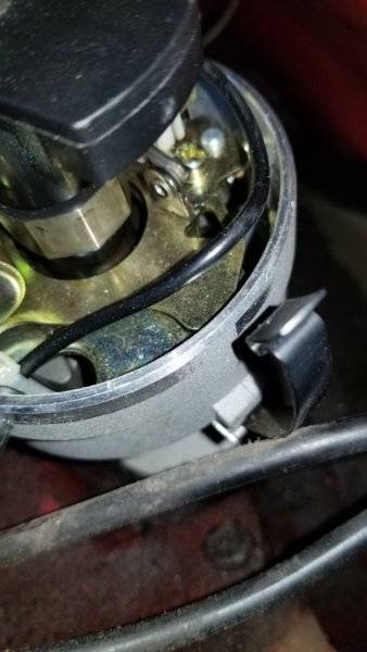

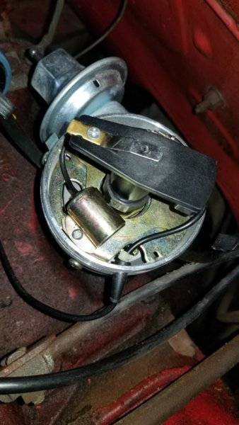

My first thought was the ballast resistor, but he had replaced that already. I was guessing an issue with the ignition system so I pulled a plug and checked for spark. It was there, but seemed weak to me. I used the info on this forum to check everything I could with ignition, all within spec. No OL when checking for resistance anywhere. No burn connectors at bulk head. Almost 7V exactly going to coil. Points look good. 12v to 7v on resistor. Check for voltage on ignition side of resistor with key on, less than .3V which I believe is fine. No issues found with ignition system, besides my apparent thought that the spark looked weak.

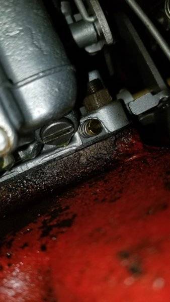

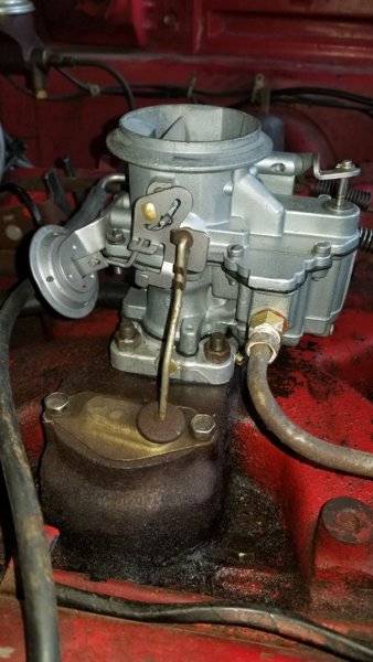

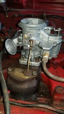

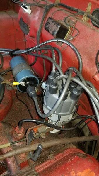

The only thing I have been able to pinpoint on the carb is a leak, coming from the very bottom (see pic). I noticed a small fuel puddle building up on top of the intake manifold when I let it sit in the garage overnight. I can see a droplet coming off the bottom most screw, though I'm not sure this would stop it from running.

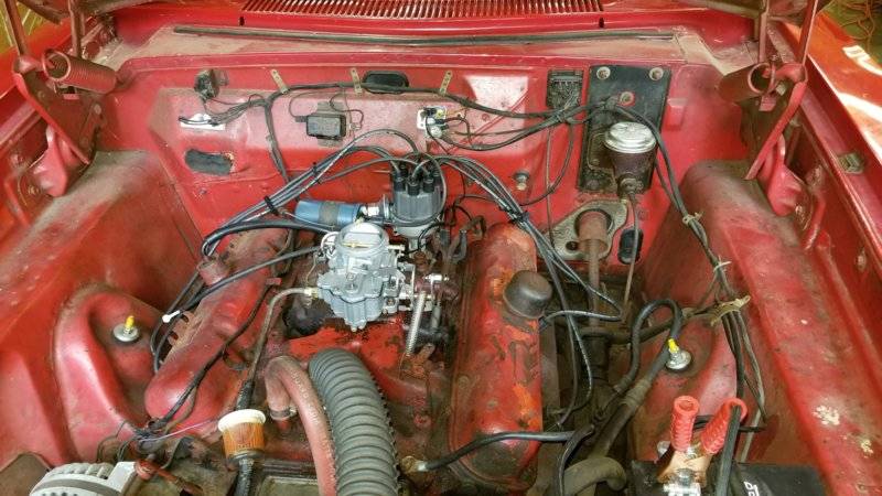

I've attached as many pictures of the engine bay and the only short videos I could capture while the engine was running, before it died.
PLEASE HELP! I'm not the most knowledgeable with these older vehicles, but my mechanical skills are strong and I'm eager to learn.

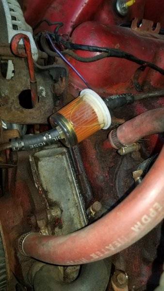

I see the fuel in the filter.Does gas squirt in the carb when you step on the pedal? Verify your getting fuel in the carb. Let the starter relax after a long cranking session. If it runs when you spray it,,,,will run if it's getting fuel.

The engine cranks so that rules out couple things. Does it have a strong turnover with no popping or misfiring? Does it pop or sound like a miss-fire when it runs for a few seconds? Any gas spewing from carb? Can the owner recall doing anything on his car between last spring and when he next drove it? While elementary, is the choke working correctly? Also check the distributor to ensure it is tight. Movement would throw off timing. Likely not an issue; but the location of the fuel filter isn't good...it should lay horizontal up on the intake. Just sayin. With all of these installs done...were they done by a knowledgeable person? I see you mentioned the distributor and maybe carb being installed by a shop; but the other parts? If not, a recheck of all wiring connections (proper connections) should be done. If a valve or cylinder is bad such as from carbon buildup, the car should stay running; poorly but running. Not sure what your reading was at ig/ballast you say .3 volts?
Do the plug wire near ground test,how strong is the spark? DON'T hold the wire!:poke:

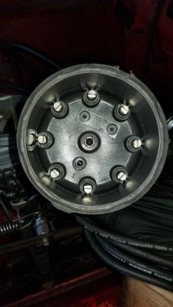

As an aside, I've seen coils that will jump a spark plug in the atmosphere but won't fire under compression. You said the coil had been replaced though. This sounds almost like a cracked distributor cap.

I started by pulling the #1 plug, resting it on the block with the wire connected, and had a helper turn the key. It felt dangerous because if the engine did fire I'd have one cylinder without a plug in it. Luckily (or unlucky for me) it didn't fire. I got a spark for sure, but it seemed like a weak orange burst and I'm used to expecting a bright blue/purple 20K volt jolt (though I usually work on vehicles that are much newer so I don't know what to expect).

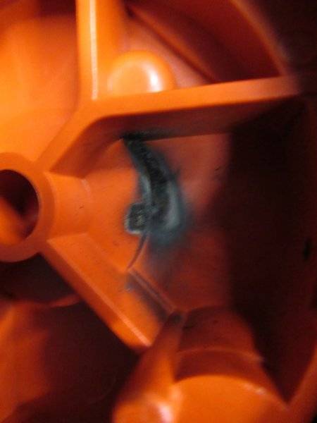

I thought cap as well, but it is brand new. I know N.E.W. sometimes stands for Never Ever Works, so I did a visual inspection of the cap and pictured it here. No issues (that this untrained eye) to see.

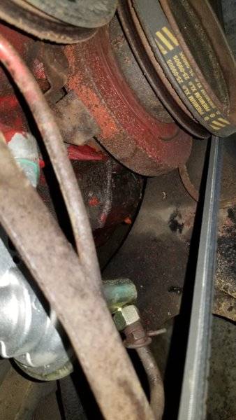

I do not know if it has jumped time. I spun the crank to where the line on the harmonic balancer lined up with the start of the metal identification tab on the passenger side of the balancer. When I pulled the cap the rotor was pointing at the number 1 cylinder. I know this isn't a true test because I could have been off, but I'm not 100% on verifying timing on this motor without it running and without a timing light (would I need to pull the front timing cover and use the marks on the crank and cam shafts to verify)?

Perhaps the carb gasket is bad.
Have you checked vaccum? Looks like you crossed just about everything else of your list.

Maybe leaking gas is sucking in air and leaning it out until it stalls?
I agree with Steve009. Massive vacuum leak. Have you checked the tightness of the carburetor bolts? Have you checked the carburetor gasket? Are there any vacuum hoses that are cracked / disconnected? Are there any vacuum nipples not plugged? Runs briefly -- means it has spark.
