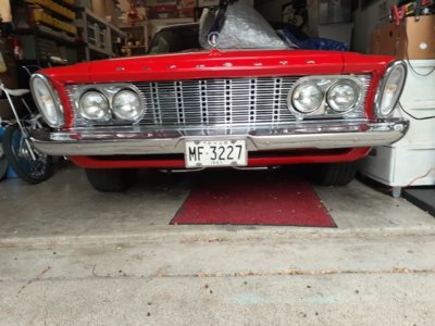

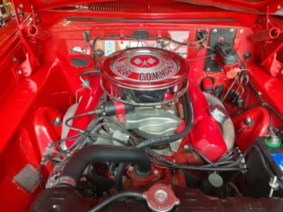

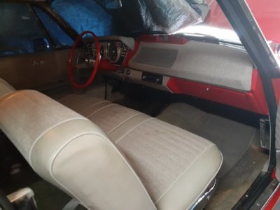

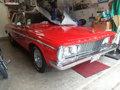

We also dig pictures if you would be kind enough to share that Texas hottie.
I would love to do that but I have new fone and no pix. I will take one this evening. It's a nice car. Stock appearing mostly. Sure don't want to make waves. I apologize. Don.
I took a pic of a pic of my 64 ss impala. 64,000 miles. 409 4spd. I'm the 3rd owner.

No comments. Good or bad on my car?
Had to step away for a bit. Looks real nice! Wait till you get a load of member's @383man s '63. Looks very similar. You can see by my avatar that I'm into the early "B" car.
