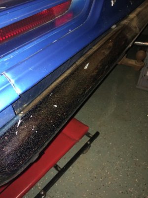

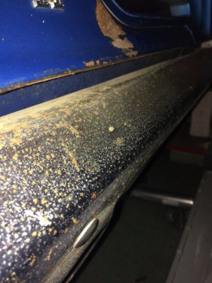

First things first....despite the fact that it had its share of the valuable “barn find dust”, i can’t work like that, so I gave it a bath and cleaned out the interior. The bumpers are straight, but they had crusted over, so I put some Judas Priest on the box, popped a few tops and got out the chrome polish and steel wool and spent a couple hours in the zone. For a preservation, they ain’t perfect, but they don’t need to be, probably just like they looked in ‘76.
