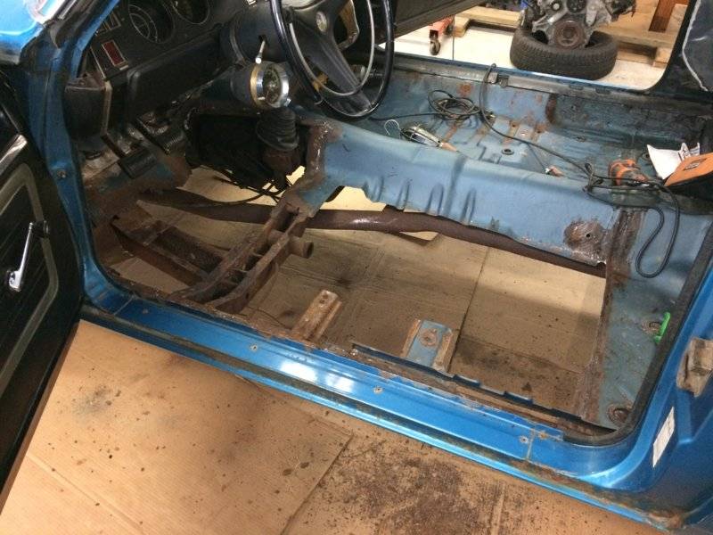

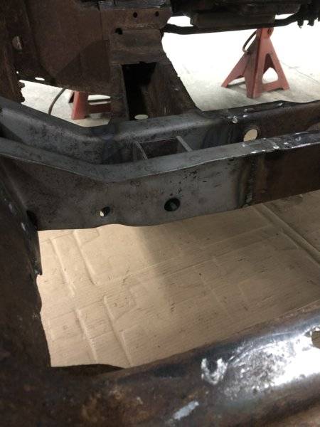

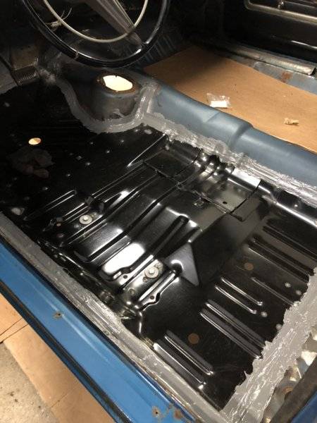

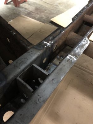

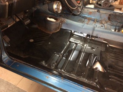

Floor pan cut out, drivers side crossmember end was rusty, so that area was sectioned out and a new end was welded in place. Floor pan is now in and complete, all seam sealed and ready to oaint.

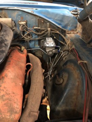

Next, all of the lines were dropped, new lines are installed, new master cylinder and all new brake components done, brakes bled and ready to go.

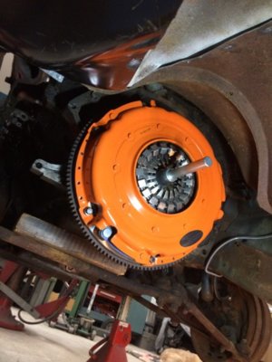

Clutch has been removed, flywheel resurfaced, new Centerforce clutch in, all bushings, linkages, shifter and all other components redone, waiting on the side cover gasket to come, otherwise ready to finish that also.

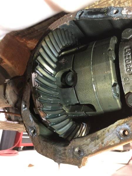

Rear end opened up, cleaned, gears inspected, new fluid and gasket, and it’s good to go.

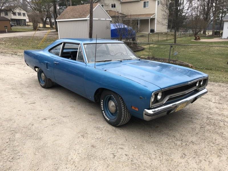

Got a little something done the last few days with this shelter at home order. Started the car for the first time, a little tune up and check through, and got to take my first drive. I wish I could post a video, but I guess that’s for gold members only. Here’s a pic after it’s maiden voyage. To say I’m pumped is an understatement. Now back to the garage for the headliner and carpet!
Real nice! Nothing can explain the feeling of getting it out on the road for the first time :thumbsup:

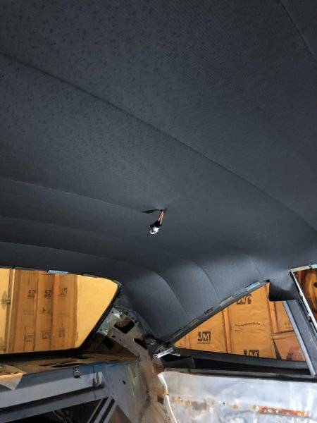

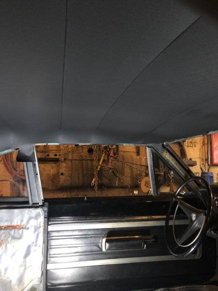

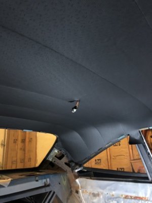

Got the headliner in today. Going to let it sit for awhile and get comfy, then hit it with the heat gun. It went in quick with a little help from my buddy! On to the carpet!

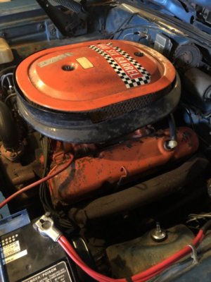

So, update! The car is all back together, interior is all in, and all systems are go! Well, they were. Took it out for another shakedown and made it about 2 blocks and it just quit. Searching revealed that the standoff on one set of points had collapsed and they were not opening. That would explain why it was running a little rough. Upon further inspection, I believe the whole distributor is worn out because it was hard, if not impossible to get the points set and dwelled in. So, I had a complete electronic setup here, and as much as I didn’t want to, I pulled the dual point and put in the electronic. I hate to say it.....but I’m glad I did. It smoothed out all of the problems I was having, rough idle, sporadic conditions and the like.
I also went ahead and changed the valve cover gaskets and did some cleaning....no, a lot of cleaning of the engine. The gaskets were easy, but the engine was covered in funk from them leaking for so long. Now, mind you, this is a preservation, so I’m not painting anything, I want it looking like this! I’m very happy with the results of the past few days progress. Now, if the Rona would just leave town, maybe the SOS would reopen so I could get some plates!
Still on the agenda are cleaning and rebuilding the carbs, and draining the radiator and putting the final mix in it! And of course, the sending unit for the gas guage from Vans doesn’t work! Rock on people, Geof

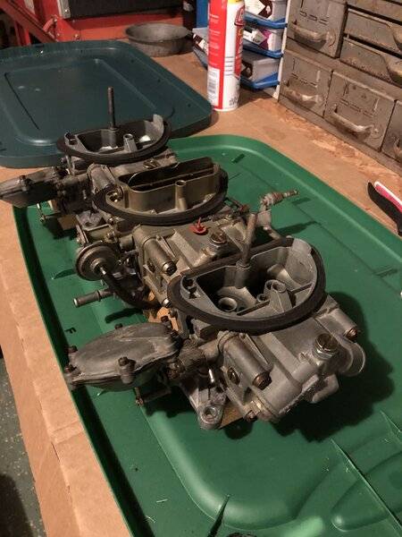

Carburetors are off, cleaned and rebuilt. Of course, the damn renew kit supposedly for 6bbl carbs only has enough gaskets and parts for about 2/3rd of the job, so I played the waiting game and everything finally came from Holley today. Well, almost everything. The kit only had 2 base gaskets, and they did not ship the extras I ordered, so it’s out and about tomorrow trying to round up a couple more! Hoping to start it up tomorrow and get it dialed in. We shall see!
Carbs back on, all dialed in, distributor all dialed in, took if for a longer ride yesterday. It now runs flawlessly, idles smooth, instant response, no lag or bog, and great pickup. On to the next project, taking it out Friday to get a full exhaust. And then there’s the problem of the valve covers still leaking. The bottom holes were brazed in each side, and obviously it’s had this problem, but I just put on new gaskets. Looks like I’ll be taking them back off and using some sealer next time. Also looking to do the rear shocks, then it will be ready for it’s first longer cruise! Enjoy your day people, it’s been a good weekend here finally!
