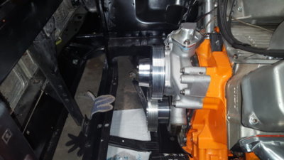

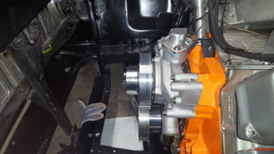

The water pump pulley didn't line up with the balancer in the first picture. CVF sent me 1/4 inch spacer which was perfect in the second picture. Told them what balancer I had they had no idea why it didn't line up
