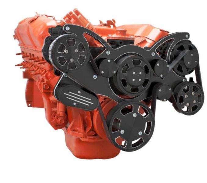

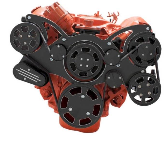

Although I was originally looking at the SD Concepts setup, because it's a great value and uses readily available accessories, I am ABSOLUTELY THRILLED, WITHOUT RESERVATIONS in my choice of the CVF Black Diamond Wraptor! I'm finally going to have power steering :bananadance::poke::drinks:
:carrot:neener-neener:bananaweed:
a beautiful, small, discreet looking, strategically placed AC compressor, a new water pump, the performance and reliability of a self-adjusting EIGHT RIB single serpentine belt, and a 140 Amp alternator! All wrapped up in a Darth Vader like, menacing BAD ASSED looking setup that goes along with my valve covers and soon to be installed Wilwood master cylinder.
