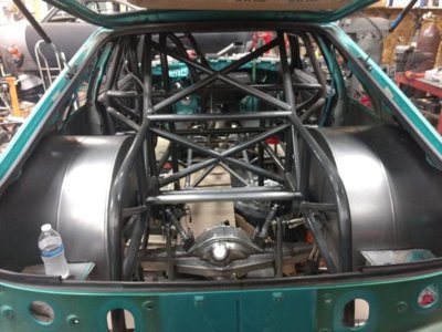

I’m sure you have plenty of talented fab guys up there! Right now I’m still struggling with the decision of going through the dash or not... it would be much easier to not, but they look really nice going through.
Here’s a picture I got off of the web of one in front of the dash. I’m not utilizing the rocker bar and the door bars will bolt in.

3” would be huge! NHRA requires 1-3/4” OD .134 DOM steel or 1-5/8” OD .083 wall Chromoly. You could mock it up with 1-1/4 or 1-1/2” (ID) sch40 pvc just to check it out.

We went through the dash on my Challenger. I think it looks much better that way. Even though I cut through the most expensive dash pad on the planet. Lol. These are about the best 2 pics I have of the A Pillar bars.
We actually have a local No E.T. buddy of mine who has a BBC on spray in a fox Body Mustang that is flying, low 8's on 10.5" tires. Our track told him we know how fast you are going, time to put in a cage. Yes, it is PVC plastic painted black with some blue roll bar padding on the door bars to make it look official...Tech's never even look at the cars on No E.T. races.
View attachment 865334 View attachment 865335
