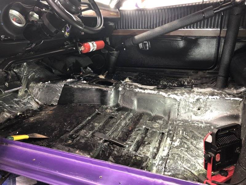

Thank goodness that’s out....

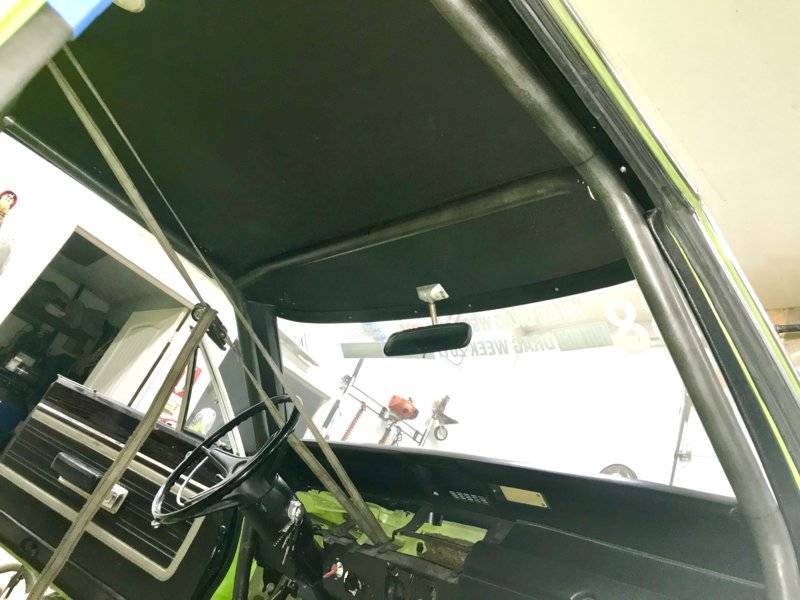

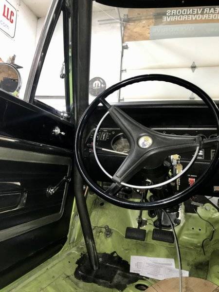

A-pillar view. It’s tight to the door but the windshield bar will cause a visor delete. I might add a tint bar across the top of the windshield. No big deal. This will have removable door bars. The old door bars made it hell to climb over.

Friend of mine fabbed up an aluminum spacer to drop the rear view mirror below the halo bar.Yea......no visors:(

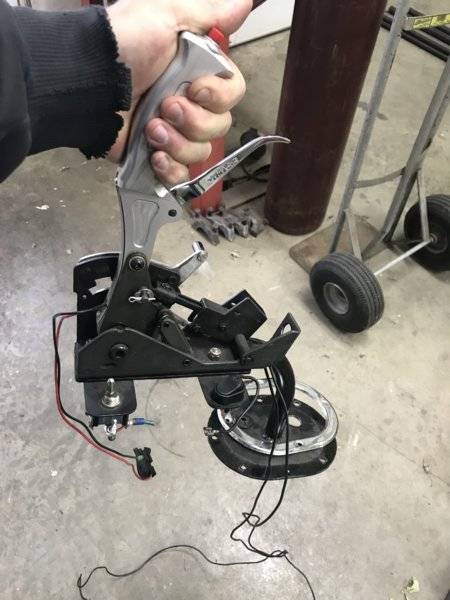

Built 727, 3.73 gear and a GV OD. It’s a 4spd car, but auto trans now but still a Hurst pistol grip! The GV OD switch is under the clutch pedal.

The A pillar bar looks nice. It follows the A pillar very well.
I've seen door bars that swing out and latch when closed. Are you doing something like that?

Technically, they will be able to swing out, but I’m more interested in having them completely removable for street driving.
Good deal then it will be right. Seen a couple of them that didn't come close as a good Halo. Had to make a new ones. But if you are making it you will get where it needs to be. Good luck the project
Thanks. I should be able to get it right. They almost need rolled for these cars rather than bent but I don’t have a roller.
I hear that again good luck you'll be fine the only thing I can say is do the bending slowly.

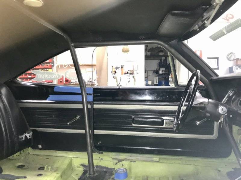

So... bending up the windshield bar, I decided to see what it would look like to try and retain visors and stay well behind and above the mirror.... it’s currently sitting under the first headliner bow. Going farther forward turns into a real nightmare. Opinions?
I think it looks fine.

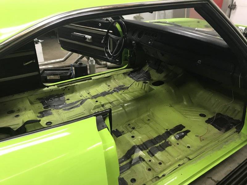

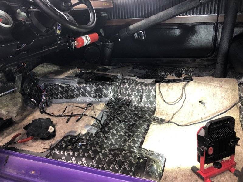

Once I get the deadener removed, you can come practice on mine if you wish. ;D
58C5F5F6-42E7-4634-A523-679A4360F358.jpeg 59D9F021-99C6-4C93-BE86-163F5C55EBA1.jpeg
Oh I know I have the power. Figure if I lighten the load some, it should help ease things up a bit. When all is said and done, I should be down over 200 with the aluminum block and a few other things.
I was at 4070-4100 with driver, depending on fuel level. I’m hoping to be under 4000 this year. 3800 at the line would be amazing for my pig.
