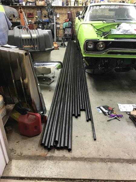

Forgive my ignorance, I know what it is, a really cheap looking rollcage. What did you cut it out of?

I’m sure you have plenty of talented fab guys up there! Right now I’m still struggling with the decision of going through the dash or not... it would be much easier to not, but they look really nice going through.

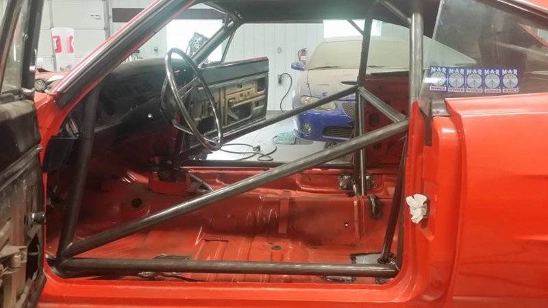

Here’s a picture I got off of the web of one in front of the dash. I’m not utilizing the rocker bar and the door bars will bolt in.
I see a pile of black steel pipe on the floor and I get all giddy...
(old fire sprinkler guy here)
