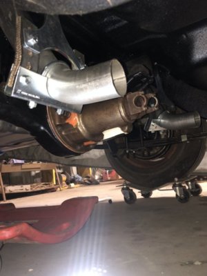

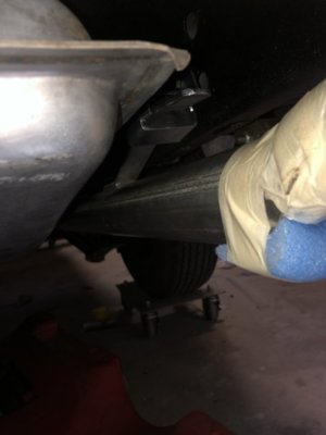

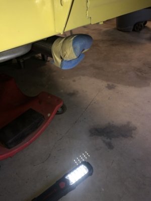

Ok I searched to see if anybody has had this problem but couldn’t come up with anything. I plan to call TTi tomorrow but thought I’d ask you guys today and maybe get this cleared up today. I started installing my 2.5” kit from the rear as they suggest. Installed the rear hangers by the bumper and the hangers in front of the axle in the stock locations. Installed the pipe and it’s about 3” to far forward. The rear most hanger is all the way to the slope of the tab so I can’t go back anymore. Has anybody experienced this or can you see what I’m missing?

Can you take a better picture of the rear hanger bracketry as you have it installed and post it.
Also do you have the tubes on the correct marked sides.....
Keep in mind you fit everything up first and adjust after and then tighten it up.....
I mounted them where the factory ones were. There’s no other holes it could go in that I can see.

68 Super Bee. Not much instructions to them with mine. I’ll check the part number for each side and make sure again. From what I can tell it’s about 3” to far forward. The rear mount is in the factory place about 9” or so from the rear of the frame. I posted the best pic I could get.

Is the highest point of the tailpipe currently over the Center of the axle? If it is also about 3” too far forward you definitely have to move the tail pipe hangers back more. I just went and looked at both my 69 Belvedere and 69 runner and there are holes in the rear subframe about 3” away from the factory location of tail pipe hanger closer to the bumper. This may be your problem, even though tti says it SHOULD utilize the factory locations they also mention that you MAY have to drill new holes.
If you could shine a nice bright light on the rear subframe and how you have the hangers bolted on now that would be a big help to me. As it is now, the picture is to dark to see.
