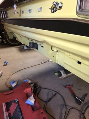

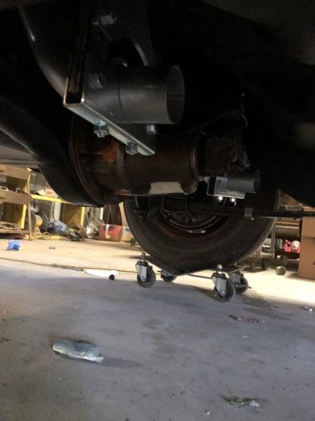

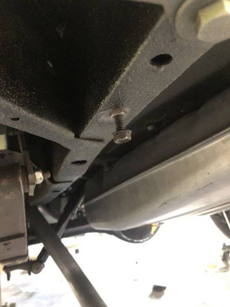

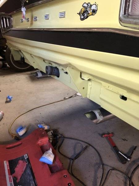

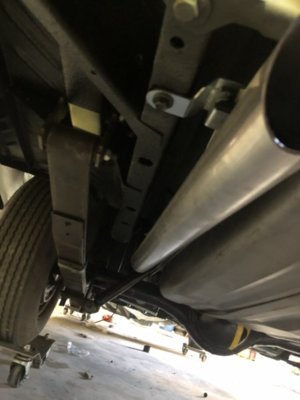

I plan at the moment is to open the hole a bit and weld a nut in to the hole. There’s nothing in there to tap other than the thickness of the frame itself. My other wonder is when I install my tips the pipe and tips will be competing for the same hanger. I haven’t got that far though to figure that one out. But it look like the tab on the pipe will need to be cut off and the tip be the support.
The oem set up is that the tip hooks to the bracket as per my photos. When I install mine it’s tail pipes only, no tips so our set up differ slightly in that respect.
