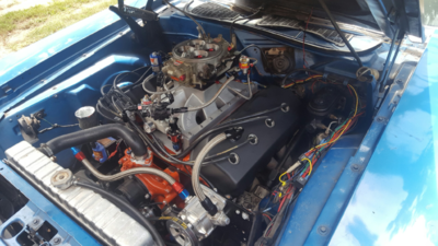

BioMed....Speaking of high end builds my 1011HP 572 Hemi has a Molnar Crank and BME (Bill Mitchell) forged aluminum rods....best you can get...it also has a Donovan Gear Drive up front.
Heck, why not just build a Hemi to start with....think about that....
Get a Hemi block rather than a wedge block to start with then go from there.
Don't get real crazy with valve spring pressures, etc and the motor would be real reliable.
You can top it off with a Ray Barton Single Plane intake with a 1450 Dominator and easily make 900HP. And of course, the Hemi blocks are 4 bolt mains so making well over 1000 up to 1500HP is not a problem for that block...no worries about girdles, etc...and put on all the Nitrous you want.
again..think about it...Want to be a hit at car shows, etc...this will do it !

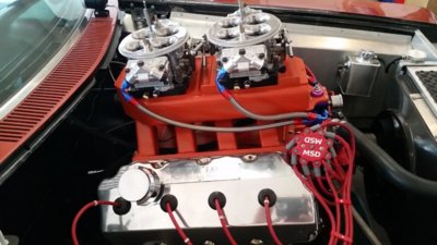

1st picture is my motor but 2nd picture shows a nice Hemi with the Ray Barton Single Plane intake and a BIG Dominator (plus I think there is even Nitrous on that setup) plus looks like it has a vacuum pump setup.
