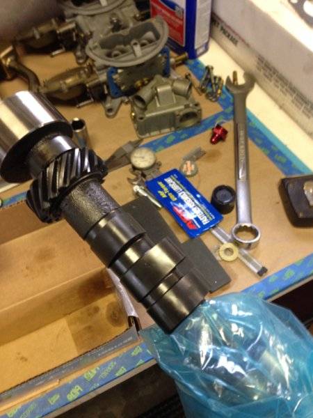

you’ll be happier. Properly set up they (the flat tappet) is pretty much maint free. I adjust mine usually no more than twice a summer and it’s usually a waste of time pulling the valve cover. Keep in mind Ray Barton uses tons of flat tappets in big HP street motors. My buddy has a 470 cube hemi that made 780 on the dyno. It’s a flat tappet motor and he drove it everywhere. Only downside to his combo was it was a race gas motor. Flat tappets will make power, you need something combo specific though. Off the shelf cams seldom give desired performance in something like what you are building. Also keep in mind if you really wanted to reap all the benefits of a Roller they are not street friendly. The one like I have for my hemi is a compromise on the ramps so it doesn’t kill the valve springs and valve train. If it were a race only motor then I would use a much more aggressive ramp.
perfect for the 421 Pontiac.
