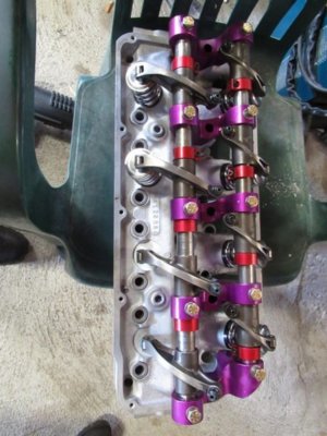

This is where good quality rockers are critical in my opinion. T&D or Jesel are worth every penny. Some of the other brands would be lucky to hold lash that tight.

We run T&D paired shaft rockers. Trend 7/16"×.165" tapered push rods, Pac springs, retainers, locks, and Jessel belt drive

I have been fortunate with my rockers. When Barton 1st came out with that rocker system for $2800 is when I 1st started wishing for them. They will never be within my reach as my budget gets smaller and smaller.

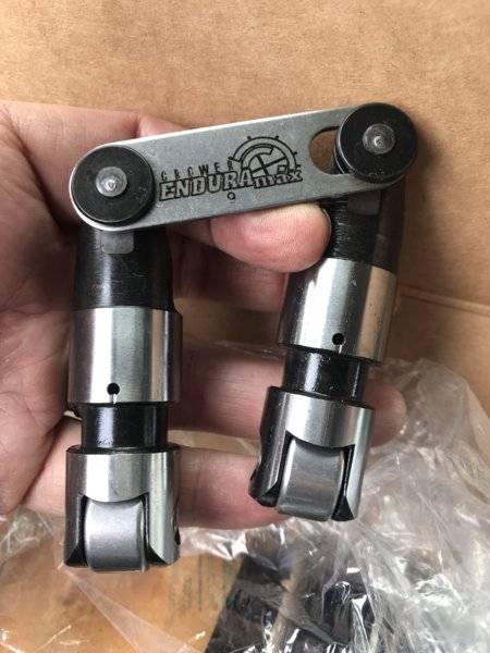

this is what I chose for my Hemi. These are needless and spec’d out for Best Machine. They also did the bushings in the block. I wanted to go with a proven set up. After talking with them I decided to set mine up “their way” as it works well on the engines they build.

So those are needle-less, and the lifter bores have bushings.
I am trying to learn here, so please bear with me, the bushed lifter bores:
Provide the lifters with a "slippery", close fitting cylinder to slide up and down in? Keeps the lifters from wearing into the aluminum material of the block's lifter bores?
Can be or have to be replaced-sacrificing the sleeves to prevent wear on the lifters themselves?
Is that right and is that all?
AND
The needles of a roller lifter are in the roller?
If yours are needle-less, the roller rolls on a bushing?
How long does that last broadly speaking, and what do you do about wear?

Lifter bushings are used to correct geometry, control oil, and in the case of your aluminum block provide a proper surface for the lifter to ride on. With good oiling they will last a long time but, can be replaced if they become worn or damaged.
the bushings in the lifters are “suppose” to be more durable. Mine are also pressure fed to the wheel. You also loose the risk of needle bearings flying everywhere if you do have a failure. My comp 829’s were wasted every 2 years in the HEMI. (Had to send them back to comp for rebuild) I expect a longer service life out of the Crowers. Although keep in mind I don’t drive this car a crazy amount. That’s what I built my roadrunner for (hence the flat tappet)in that one. The Dart is more for going out and making a blast and putting it back in the garage. It’ll see local cruise nights. Nothing crazy.
