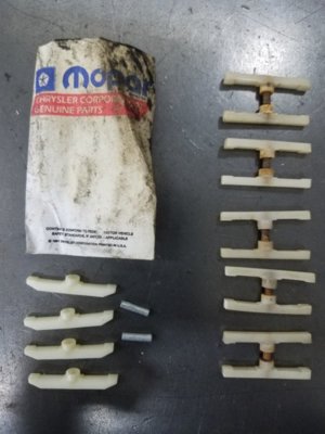

Decided to tackle the glass division channel guides. Unfortunately at this time we are stuck with some poorly made very expensive pieces of plastic reproductions. Supposedly DMT was working on getting a run made of quality ones, but has since given up. Another member mentioned that Tonys Parts has them in the works though and we need to hope that he can get them made. I found that the best way to cut them was to use a small sharp scissors used for trimming finger nails and a razor blade. For the 2 holes, I first tried a hole punch. I found that the material is quite brittle and it would crack/split when hitting it with a punch. Also it was about impossible to get the holes in the correct spot. Another member mentioned using a solder iron, and that worked great. Hold the piece exactly where it needs to be and gently plunge into the hole. Then very gently clean the melted chunks off with a razor blade. I also trimmed about a 1/16" off both outermost flaps. I cleaned up my old plastic guides and reused them because it was mentioned that the new repops are slightly over sized.

Lookin Good Joel! I used that method to remove a door glass in a salvage yard. I think I put mine back in all together though with some help from my wife. Mine went together pretty easily since I had some NOS Mylar sliders. I did use my old plastic guides. I used a hole punch for the holes but I like the idea of using a soldering iron. I helped another guy install a set of the aftermarket glides and found what everyone else is saying. They don't like to slide in the channel and they are more brittle. We ended up tweaking the channel on his to get the window to slide the way it should. I can't wait to see your Bee in person.
