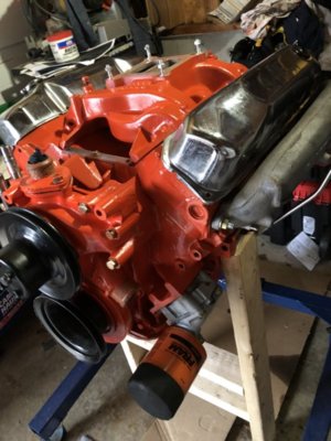

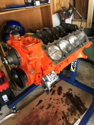

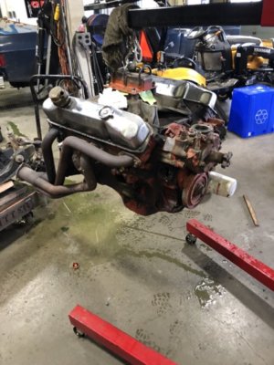

we pulled out the old 383 and have the new one -below- built and ready.

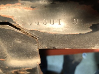

the vin number on the rad support-upside down-100023
and on the trunk
