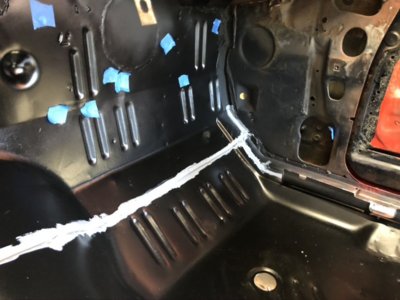

Also sealed the interior seams. I used the 3M Dynatron and it was really easy to work with.
