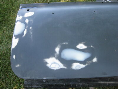

I want to start a thread where us beginners can post questions for the pros and experienced body and paint guys. I have so many questions, it seems silly to create a thread for each question as it comes up.
My first question: After blocking and feeling satisfied with my body work; do I need to spray a final application of primer before I paint? Or, can I paint over the body work as shown?

I always recover any non primed areas. Then block down

A good priming will have multiple blocking, repriming possibly 4 times.

You’ll want to use a primer surface over that type of body work. Block again. Once your done with all that you’ll use a sealer before final paint layer.

Just like 69L48Z27 said, "You’ll want to use a primer surface over that type of body work. Block again. Once your done with all that you’ll use a sealer before final paint layer."
I would only add that if you are new to this, spray some guide coat on your panel and then lightly block (before your seal coat). The surface can feel smooth but still have highs and lows that will show when painted. It is very cheep insurance that this doesn't happen. Then you can seal coat it.
Few points... What are you using as a sanding block? How big? Are you using guide coat?
If you paint over what you have shown above you'll see the sharp color contrast through most paints.... At least shoot a sealer.... Personally I'd re-prime, guide coat & cut it again... I've never heard someone say "I blocked that panel to much".... I've heard lots of folks say "I should have blocked that panel again".....
I like Dura-Block sanding blocks, I prefer at least a 12" block, if the panel is mostly flat or a convex curve I like using an 18" or bigger block... The longer the block the flatter/straighter you'll get the panel.... I have a 30" block for doing roofs....
Guide coat is typically misting black spray paint over the fresh primer, that way when you sand the high spots immediately become apparent cause you cut the guide coat off as soon as you start sanding.... The low spots keep their black speckles till you've cut the high areas away around the low spot....
Depending on how bad the highs & lows are you might want to break out your body hammer... Pecking down high spots & pecking up low spots...
Also if you have a low spot & you plan to re-prime a little extra heavy on the priming in known low spots can help straighten a panel...
