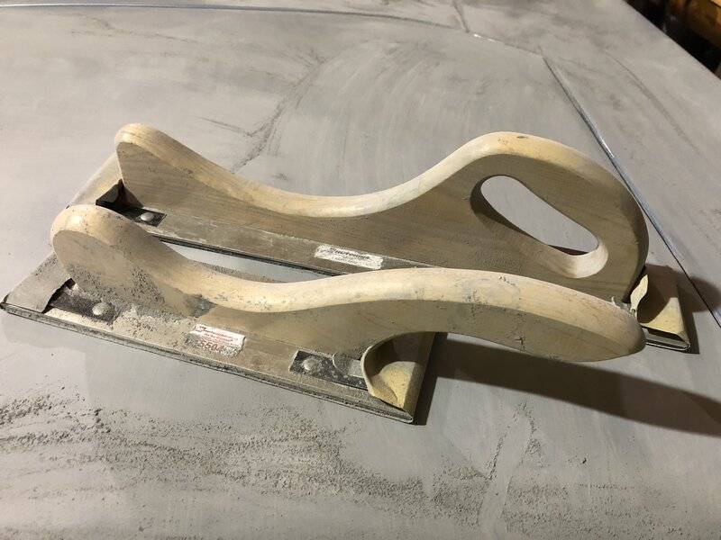

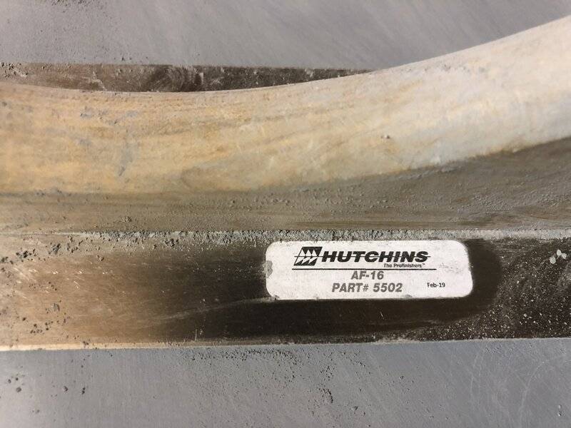

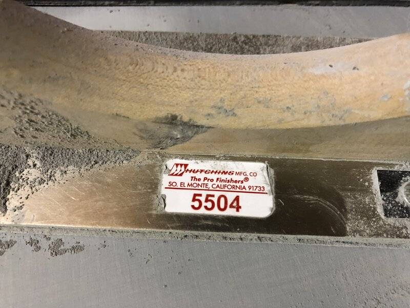

Good sanding blocks are very important. I have a large collection of blocks. I have every block that durablock makes and I only use a couple of them anymore. I’ve found that, for getting panels really flat, a Hutchins block is far superior. They don’t flex and cannot be pushed into the “lows” like a durablock can.

Hutchins blocks are good, no doubt.. I still prefer the Dura-block but like I mentioned earlier, don't push, like the paper do the work..

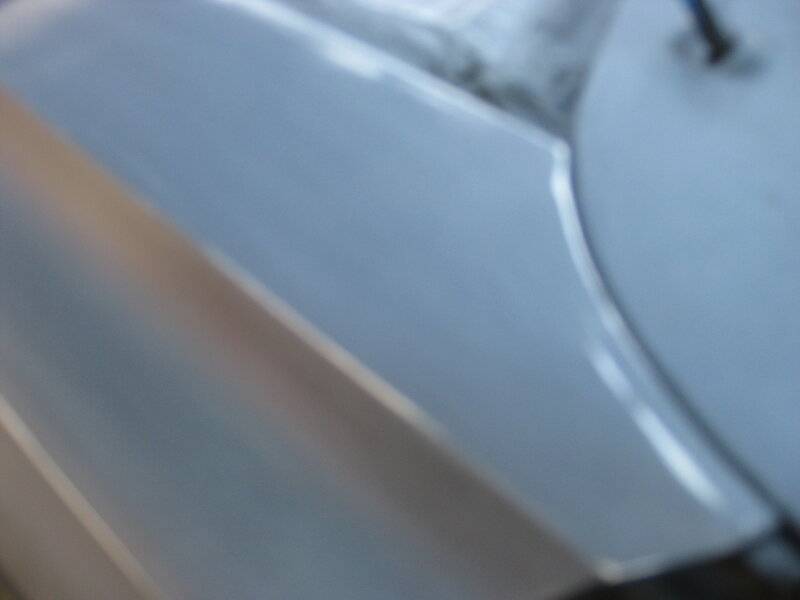

Few points... What are you using as a sanding block? How big? Are you using guide coat?
If you paint over what you have shown above you'll see the sharp color contrast through most paints.... At least shoot a sealer.... Personally I'd re-prime, guide coat & cut it again... I've never heard someone say "I blocked that panel to much".... I've heard lots of folks say "I should have blocked that panel again".....
I like Dura-Block sanding blocks, I prefer at least a 12" block, if the panel is mostly flat or a convex curve I like using an 18" or bigger block... The longer the block the flatter/straighter you'll get the panel.... I have a 30" block for doing roofs....
Guide coat is typically misting black spray paint over the fresh primer, that way when you sand the high spots immediately become apparent cause you cut the guide coat off as soon as you start sanding.... The low spots keep their black speckles till you've cut the high areas away around the low spot....
Depending on how bad the highs & lows are you might want to break out your body hammer... Pecking down high spots & pecking up low spots...
Also if you have a low spot & you plan to re-prime a little extra heavy on the priming in known low spots can help straighten a panel...
Just a little to think about...
I have a Durablock set which includes a 12" and an 18". They work really well. After blocking the body work, additional coats of filler primer and blocking again makes perfect sense before painting. I used a guide coat to get the body work where it is now, then checked it with a straight edge. It feels like glass.

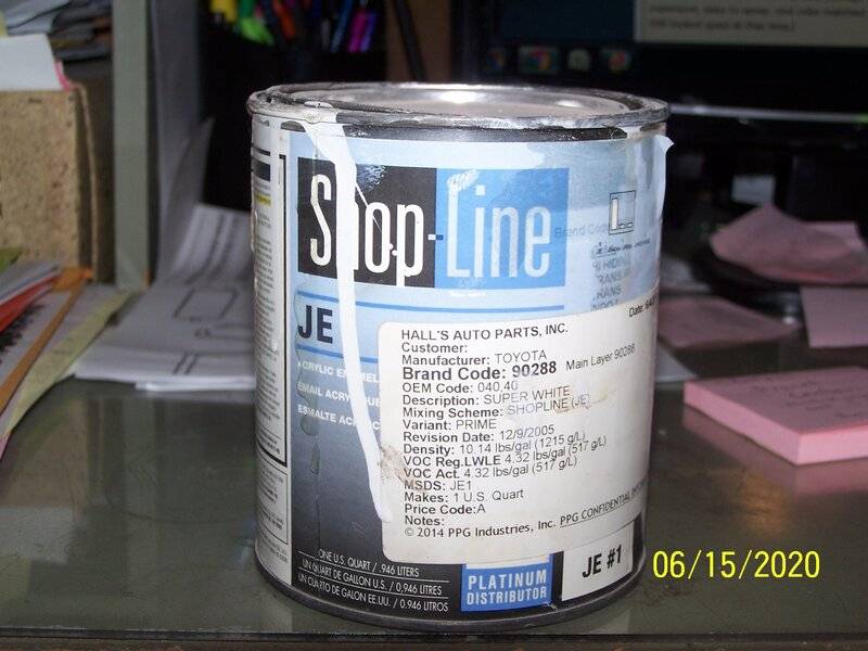

What is a quality, easy to spray, single stage paint these days? It has been 9 years since I painted a car and the Centari enamel I was last using is no longer made. It's going to be a light colored non-metallic job.
Dupont Centari and Imron, now that is going back a little. I think Imron is still available but is expensive and doesn't flow like it did in the late 70's. Pretty sure Centari was phased out starting in 2012.
Back to your question about a quality single stage. I have used and like PPG Shop-line series JE acrylic enamel. Last time I sprayed it was for some deer damage back in 2014 and the color was Super White on a Toyota. Not very expensive, easy to spray, and color matched just fine. Not sure how it holds up as I sold the car a couple of years later. Still looked good at that time.

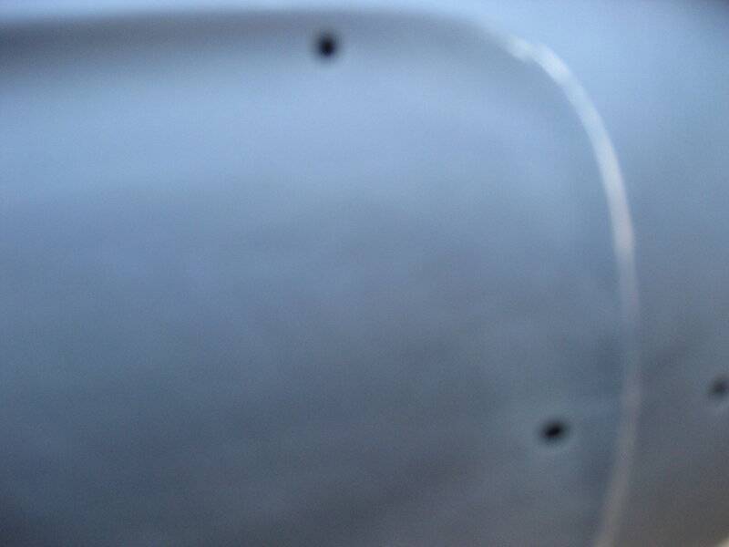

As I sand my car for paint; I have these areas where the primer is thin and small areas of bare metal showing. Do I need to cover all these little areas with primer, or is this small of an area not an issue?
I would recover the light spots but the pros will tell you best. Good luck
As long as your bare spots are not any larger than shown and at least a 400 grit feather/finish you can seal over them with your DP ect as long as its metal.
If you have any bare filler pop up you need to prime , bare filler will ghost ring on you.
