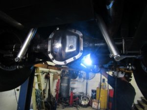

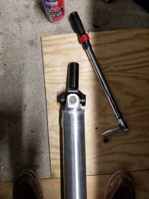

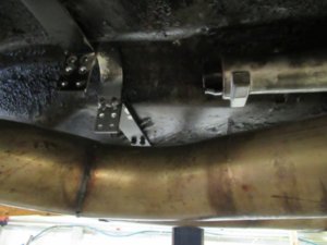

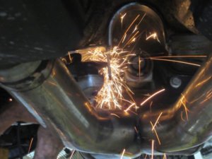

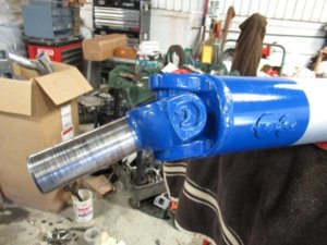

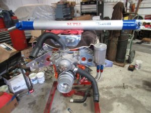

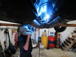

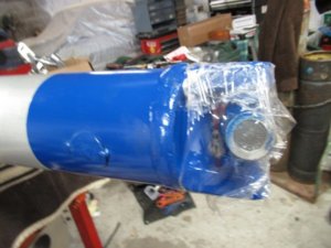

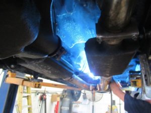

I'm lucky to have s friend with a Driveshaft shop{cheap plug} http://www.supershafts.com/ Make me anther shaft,this time it's a 4 inch aluminum shaft.He said it would handle whatever I threw at it! At 3700 lbs and any decent amount of power you have to have the right one.I broke a rear u-joint coming out of the gate many moons ago..........
7.31.17 017.jpg 7.31.17 018.jpg 7.31.17 019.jpg 7.31.17 020.jpg 8.23.17 009.jpg 8.23.17 014.jpg 8.23.17 015.jpg 8.23.17 016.jpg 8.23.17 019.jpg 8.23.17 020.jpg
View attachment 571693 View attachment 571694 View attachment 571695 View attachment 571696 View attachment 571697 View attachment 571698 View attachment 571699 View attachment 571700 View attachment 571701 View attachment 571702
