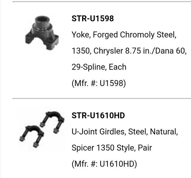

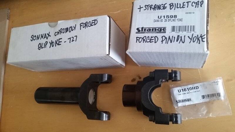

Another very important thing....as I don't see any mention of it yet....You gotta have a SONNAX Forged Slip Yoke. You can get it from Summit.
I also use a Strange forged pinion yoke and strap.
I didn't ask the brand, but the slip yoke for a 1350 U-Joint is included at $700. The 1350 pinion yoke was $165 but I didn't ask the brand of that either. Thanks Mike!

View attachment 965092 Another very important thing....as I don't see any mention of it yet....
I also use a Strange forged pinion yoke and strap. You cant be too strong. I also use 1350 u joints...as we all know when the driveline fails it usually takes out the transmission also.
My 64 572 Hemi makes 1011HP and 805TQ so I can't afford to have any weak links in the driveline... What ever your HP and TQ if you upgrade and spend the extra money to start with for these parts you will never have to worry about them again.

I'll have to ask whomever I get with for the driveshaft about the transmission slip yoke..
30 spline slip yoke for the "Hemi" 18 spline a833, right?
