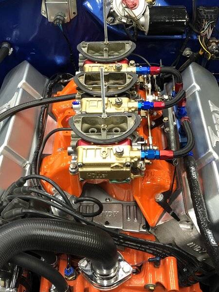

there’s going to be no bad choices with your combo. I’ve ran several different intake and carb combos on the 512 in my roadrunner (which is a street car). It likes big carbs, dominators. It also likes single planes. I even ran a M/W port Indy on it (my heads are big standard port) and it flat screamed with a 1050/4500. I transitioned back to a six pack for looks. I had to do a lot of work on the six pack Intake to make the motor happy. The distribution/idle quality suffers a little with the dual plane. It’s still pretty damn fast though, I just think the singles have better drivability on the 500 cubers. Torque has never been an issue with any of the intake/carb combos.

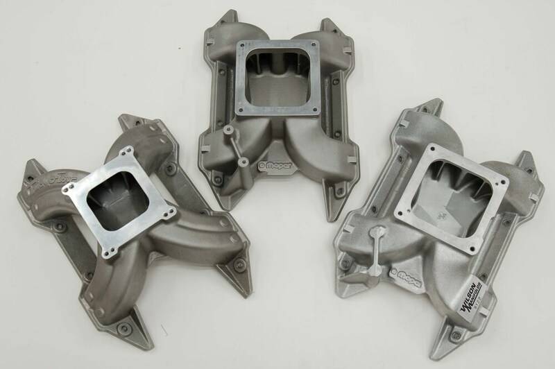

I know AndyF recommends the Trick Flow Intake for 470-512ci. with a 4150-carburetor. If I was buying an intake manifold today, that would be it, it's one of the best on the market.
On my 470, I'm running the M1 4500-manifold, it's really tough to find and completely different from the M1 4150-manifold (which I wouldn't run on a low-deck with large displacement).
The options are pretty slim for a low-deck compared to the RB. Even with the few options we have available, many don't have the same port-volume as the RB intake manifolds. With large displacement, you really need the additional port volume.
Mopar M1 intake is pretty good if you can find one.

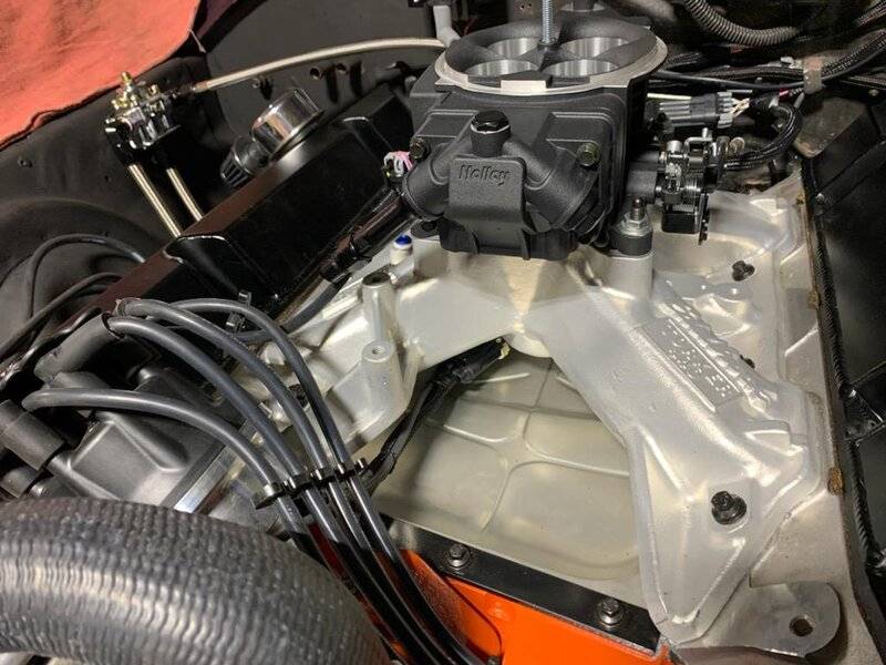

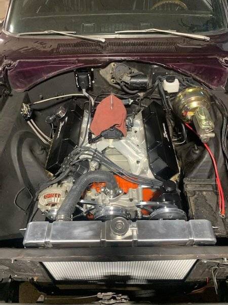

You have pretty much all the information you need in the responses So the only things i will address is the Holly sniper EFI that you suggested interest in running, I went with the hyper spark ign. and the Holley sniper stealth EFI. I have them on an old school torker single plane intake because I wanted the better fuel atomization and added torque at higher rpm from the single plane. You will have a TON of torque on the bottom with a stroker to start with and the fact the its a 4 speed you can start where ever you want in the rpm range anyway. After taking the time to get everything adjusted correctly I LOVE the EFI!! No matter the engine temp I have 1-2 second engine crank before start, throttle response is instant and the ability to view and or adjust anything having to do with the fuel or timing that I want to at any time. Or I can chose to set it and forget it. No I don't want to butt heads with all the carb guys I get it I am saying that in my application and experience EFI has worked very well and exceeded expectations.
My set up is a 440-512 440 source kit with the Stealth heads and a smallish .525 231/237 on 110 cam ended up right around 10.25:1 i have full TTI header & 2 1/2 X-pipe system with Dynaflo super turbo mufflers. I dynode at 530ish hp and just under 600FBT but i carry upper 500's FBT fbt from 3000 to 5700 rpm though my 18 spline 4 speed 3.54 gears and 28 inch tires running hard I can get rubber into 3rd gear (Street tires). I don't know exactly what you are looking for but for me it was a good place to start.
