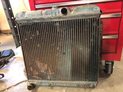

Well I took my original radiator a local shop. Said it had so many leaks that it would cost $600 to fix.
What should I replace it with? I don't know what size or how thick it is. 383 engine. I don't need anything for racing, just want something that will cool good. Might be adding A/C to it.

22" or 26"? Glenn Ray $1200, Griffin close to the same. There are a lot of aftermarket radiators some look similar to original, many don't. For $300 or less you can keep your engine cool, just depends on how cool you want it to look.

1st thing, measure your radiator. The core support will either take a 22" or a 26". You cannot put a 26" in a 22" slot. Measure the "core" part of your radiator left to right to determine which it is. Then you can decide where to go from there. US Radiator has a nice aluminum w stamped tanks that look close to stock when painted black for under $600. Other aluminum are usually square welded upper n lower tanks. For a stock 383 w air, a 2 row w 1" tubes and a factory shroud w fan clutch and proper size fan will be more than adequate. If your tanks on your stock radiator are good, a recore w a 3 row brass using modern core spacing will work too. Find another shop for an estimate on recore. But brass is expensive compared to aluminum.
So, it was like this?
