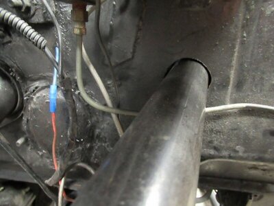

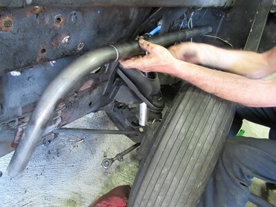

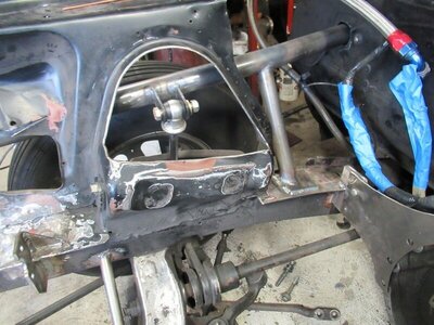

Another good idea is bracing and triangulating the firewall to the front of the chassis.That really stiffens the front of the car.
I hear ya, and I think that too can be part of the stroker, blow proof bellhousing, dual disc clutch setup process.
Doesn't USCT have some parts for that, or what would you recommend?
Since I'm adding front and rear torque boxes and subframe connectors NOW, I'm thinking of doing these when the stroker goes in:
I'm going to have to do some kind of roll bar too, so that may help??
I also may go to an engine plate to replace the motor mounts, IF I HAVE TO.

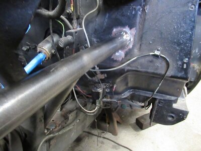

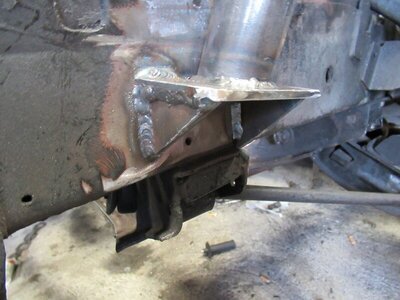

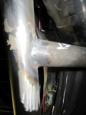

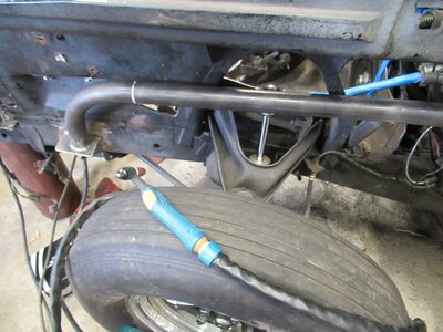

They are called "J" bars or snout bars.Goes from a welded plate on the firewall to the front of the chassis. Mine goes through the firewall to the front hoop.

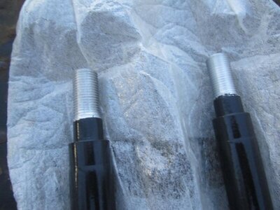

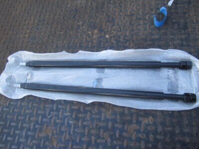

I already had these with everything else at the shop to be installed. I'm replacing practically EVERYTHING in the front suspension!

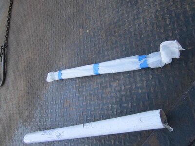

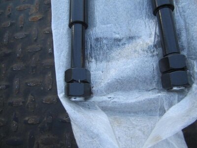

QA1 strut rods
Those might be better,but I stole a pair of aluminum powder coated strut bars for part 3 of my Jenny Craig diet.
4.11.17 014.jpg 4.11.17 015.jpg 4.11.17 016.jpg 4.11.17 017.jpg 4.11.17 018.jpg
Description of the QA1 strut bars:
QA1 dynamic adjustable strut bars offer improved performance for your Mopar suspension. These lightweight bars are made from of 6061-T6 aluminum and are anodized....they're fully adjustable and include rod ends. Maintain alignment of your lower control arm and eliminate binding for faster weight transfer with QA1 dynamic adjustable strut bars.
View attachment 971434 View attachment 971435 View attachment 971436 View attachment 971437 View attachment 971438 View attachment 971439 View attachment 971440 View attachment 971441 View attachment 971442
Honestly, after seeing those, and I've seen that done before, I'd be a lot more inclined to do the USCT bracing here:
and I'd only do the kind of braces you did if I had to, or absolutely should, and that would be when I put the roll cage in.

As for a roll bar with 'J' bars to the front.....if you can, incorporate them into the build of the body stiffening job. It'll be easier and cheaper over all if you do that before the car is together. Only thing different than HEMI-ITIS's J bars is I like mine inside the inner fenders because brackets can be welded to them and are usually more solidly mounted than welding them to the sheet metal.
I'd like to know more about that. Does that mean I wouldn't have to remove the fenders? Can I skip the USCT fender braces if I do the J bars?
Any of you who can go into more detail on this, I really want to know more. For one thing, I don't see this happening now, as I don't see how that can be done without removing my front fenders, and I'm running out of money. I also don't want to keep adding to the job my mechanic has agreed to, and I'm lucky that he's taken a personal liking to my car and this project, and told me just a few days ago not to worry about having added the torque boxes, spring hanger plates, the subframe connectors (he recommended) because he wants to see this done right.
I have to draw the line somewhere though, and if nothing else, I can't afford to add anything else to this "stage".
I am making notes for the future though, and if I should do J bars, OK, but maybe when the USCT inner fender braces go on, because that requires the fenders to be removed, that makes sense to do both then. THAT is how I do stuff too-if I'm in "an area" or working with "a system" I try to do whatever is in that space while I'm at it.
Capiche?
Sliders are good, just use White Castle :D Seriously, sliders are good but the closer you can get to 50/50 weight distribution, the better the CT's will work and will be easier to dial in....based on past experiences. If you do the inside the inner fender J bars, the outer fenders shouldn't need to be removed.
