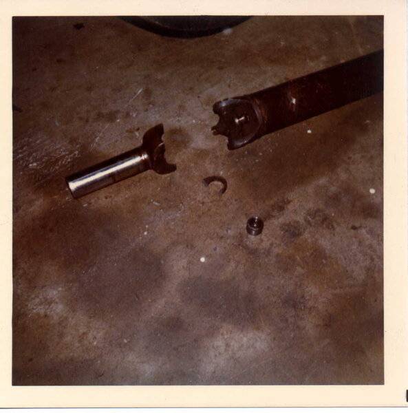

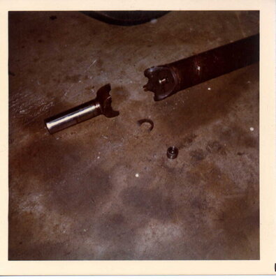

Spit the U joint cap out of the front yoke or the front of the drive shaft due to poor fit or clip failure. My bet is it bent the output shaft, broke the tail housing. The floor probably took a good whack as well. look for a missing u-joint cap. Not the first tie I've seen this. Trans damage actually wasnt bad

Usually it is not joint or yoke failure itself. The retaining clip for the u-joint cap breaks. Most often because the cap wasnt fully seated in the yoke or shaft. Then the cap flys off. Now there is way to much play and vibration. Then failure. Has nothing to do with the low roller (sprag). Just had a buddys race car do this at the top end of the track. I'll be fixing the trans next week when he pulls it. Last one I fixed that did this only needed a tail shaft housing and shaft. Along with floor and console repair. The rest of the trans was fine.

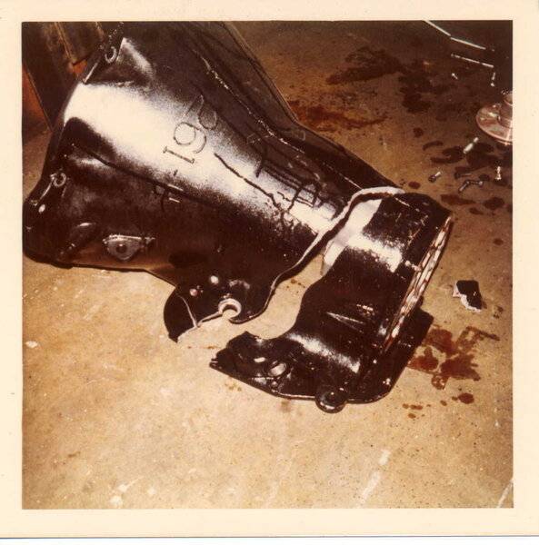

When you say that the trans "exploded", what damage to the case & tailshaft? Check the internal components to see if the front clutch drum is intact. Not likely the trans internal components failed under those circumstances, sounds like a drive shaft failure that took out the trans. It happened to ME at 116 going through the traps, 7000 RPM. Tossed the drive shaft out the back, right over the windshield of my best friend in the other lane. Broke the bell housing off the block, disintegrated the tail housing, bent the output shaft about an inch. You obviously need a new 727 & complete drive shaft. Get a big new aftermarket shaft & 1350 U joints. Drive shaft loops are a real good idea, make sure it has enough clearance(or ability to take apart) to remove the drive shaft. One near each U joint, front & rear is a good idea too.

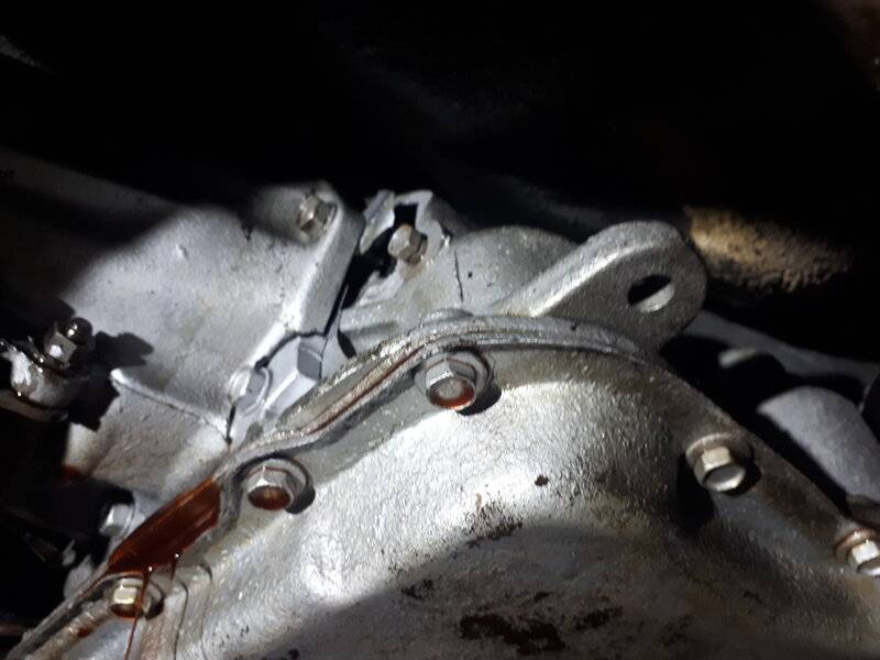

When you say that the trans "exploded", what damage to the case & tailshaft? Check the internal components to see if the front clutch drum is intact. Not likely the trans internal components failed under those circumstances, sounds like a drive shaft failure that took out the trans. It happened to at 116 going through the traps, 7000 RPM. Tossed the drive shaft out the back, right over the windshield of my best friend in the other lane. Broke the bell housing off the block, disintegrated the tail housing, bent the output shaft about an inch. You obviously need a new 727 & complete drive shaft. Get a big new aftermarket shaft & 1350 U joints.
The tailshaft housing as well as the main transmission housing cracked where they attach. See photo.

Probably need to look at the driveshaft closely and if possible figure out which end of the driveshaft was closer to the failure.

I wouldn't call a slip yoke failure a "transmission explosion". Same thing happened to me under the same circumstances but I had a driveshaft loop.
