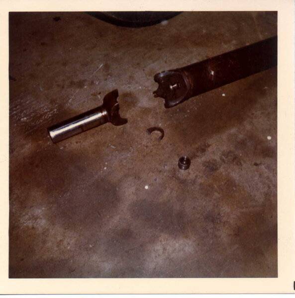

Ouch!I wouldn't call a slip yoke failure a "transmission explosion". Same thing happened to me under the same circumstances but I had a driveshaft loop.
View attachment 982007 View attachment 982009

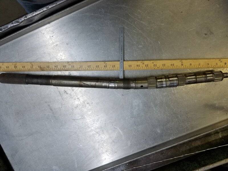

YepTrans blew apart because of the yoke/strap failure. Overrun clutch grenaded at the tailshaft/housing because it went beyond design parameters.
If you were in it to 4k rpm @100, what did the rpms jump to once it let go?
Overrun clutchYears ago I had a rear ujoint cup get loose at about 60 mph. It also broke the trans tail housing and bent the tailshaft. Driveshaft never became disconnected so there was enough vibration that i remember my interior rear view mirror rotating. I do believe the tail housing broke immediately as the smoke from fluid on the exhaust was instantaneous
Awsome transmission understand how it functionsOverrun clutch
Nope. The lower roller clutch is used in 1st gear only. They get a bad rap.sounds like over running clutch bad ****
