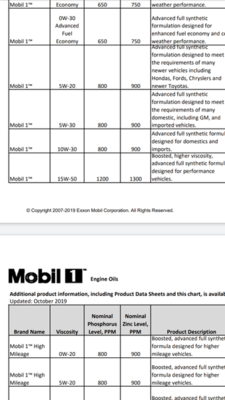

The VR-1 specifically is a conventional oil with 1300ppm zinc and 1200ppm of phosphorus. Info is direct from Valvoline website.
Screen shot of test results and I'm seeing the different VR-1
