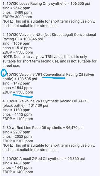

The VR-1 specifically is a conventional oil with 1300ppm zinc and 1200ppm of phosphorus. Info is direct from Valvoline website.

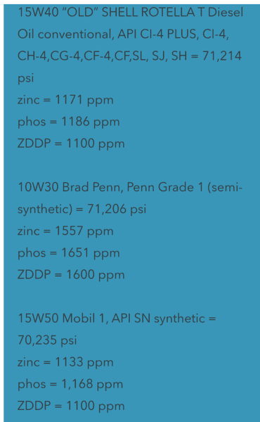

Screen shot of test results and I'm seeing the different VR-1

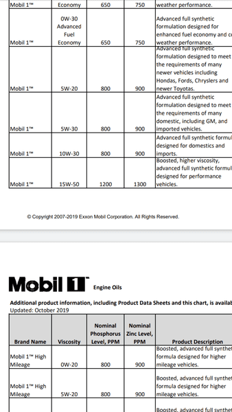

Mobil1 ain't VR-1. Just sayin'.
You're right, Synthetic vs. Conventional, but both with a comparable amount of zinc. I personally like the conventional.
Penn, Gibbs or VR1 will all work. Why change what works in your application?
