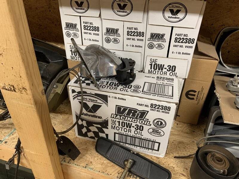

I just watch for a sale on Amazon and stock up. This batch was $24 a case.

Talking with a guy in the oil industry. Had good things to say about it, didn't have much experience with Penn and said that the VR1 lacked detergent packages and required more frequent changes.
Have been using Brad Penn 10-40 for years..love the clingability...is that a word?
Maybe with the (Not Street Legal) racing VR1. It's stated in their specs. Also refer to post #11
