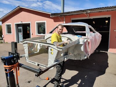

Hasn't gone exactly according to plan. After spraying the primer I was hoping to spray the Bright red but there was more work to be done with sanding unfortunately. Continuing with other misc items to refurb.

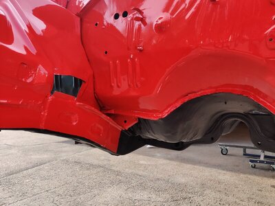

Clear sprayed, decent result. Now on to masking off the bay and spray the radiator support black and the undercarriage with bedliner. Not far from assembly now.

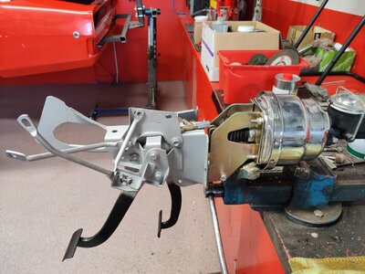

Finished the brake cylinder assembly. I'm hesitant to fitting this SSBC master cylinder, many over att Dodge Charger.com who has had issues with poor braking power with these cylinders. I checked and mine has a 1-1/8" Piston. They usually swap them for Corvette C4 cylinders since they are 7/8" bore and fit the bolt pattern. Time will tell...

My son (12 years) helped me fit the brake assembly in the car! I could use a helper.. Guess I need to bring him more often to the shop.

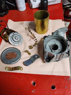

Got hold of a 3-speed wiper motor and linkage in poor condition. Cleaned, blasted, painted ,zincplated and finished with some yellow chromate on some parts. Gonna let it rest some days before reassembling. The wiring is shot so that will have to be swapped out.

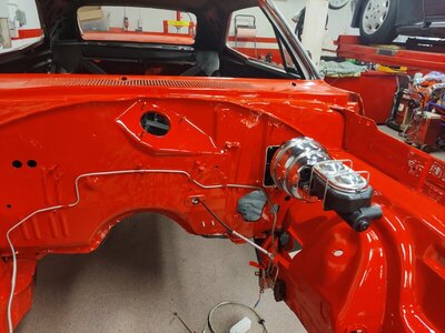

While waiting for the yellow chromate to cure I continued with the brake lines. Installed the line lock on the front line and the pressure reducing valve for the rear brake line. Reducer is easily adjusted from the outside. Can finally turn the body and start on the brake and fuel lines underneath.
