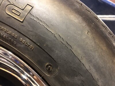

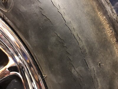

Hello all.

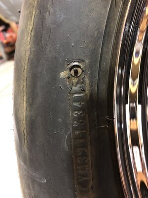

During routine cleaning and maintenance, I found several cracks in the sidewalls of my front tires.
Date coded 2015. Less than 1500 miles, stored inside and on a lift 50% of the time (tires hanging, 2 post).
this is not to bash the manufacturer, although I think 5 years is a bit on the short side.
I bought them at summit and they prorated 25% for me under a very subjective warranty.
Anyhow, check your tires, even if they aren’t all that old.

In my case, it must be an inferior rubber or something. My car stays inside out of the UV. It stays suspended most of the time. The tires are not neglected in any way.
I called Coker, and the rep basically admitted that 5 years was on the short side. He says they recommend replacing at 8. Since I bought them from summit, I had to deal with them on getting a resolution. They comped 25% of the new tires. I was glad they did that.
the thing is with tires. Even ones that look great. They are good until they aren’t, and they don’t give much warning.

When I picked up the replacements, I checked the dates.
