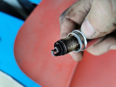

This is the first one(cylinder 1). I'm not really sure what I should be looking for. If you can give me a few things to look for I'd appreciate it.
The black around the edges is oil.... Do all eight have that?

It's an aluminum Performer RPM, and Edelbrock E-Street aluminum heads. I checked the intake bolts for looseness, but everything was good. Before I dig too far I'll have to speak to the engine builder first. Cylinders 3,2,4 have oil on the threads, 6 and 7 have some oil, but very little compared to 3,2, and 4. 1,5, and 8 are basically dry. The block was decked as part of the machinig process. Compression is supposed to be 10.1-1. After I changed the EGR valve last night and went for a drive, the smoke stopped. I pulled into the garage and held it at 2500-3000 for 30 seconds or so, and no smoke. Next up is the compression test. I'll post in a bit what I found.
