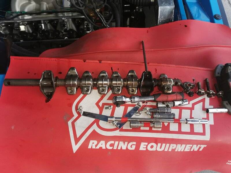

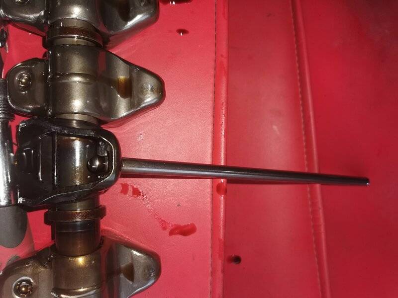

The intake rocker of number 2 cylinder was punched out. The indent where the pushrod sits broke, and was laying on the head. The rocker and the shaft under the rocker was blue from excessive heat. Obviously wasn't getting any oil. Picture below. I grabbed a leak down tester and set at 90psi, and the loss was 5%. The shop is replacing the rocker shaft, rocker and pushrod, and I'll pick them up tomorrow, and then do another compression test. I'll post again when I know more.
But why did it not get oil? How long would it have taken to turn blue from the heat? My concern is that it happens again.
Those look like used shafts/rockers... Were the plugs removed from the ends of the shafts & a bottle brush used to clean the inside of the shaft?
The shafts were used, but the stamped rockers along with everything else on the valve train is new. The shop assembled and tested the engine, so I'll assume they did what was required to prep the shafts. The shaft this rocker is on will need to be replaced, as like the rocker, it turned blue from heat and is now weakened.
Hole plugged in rocker shaft or hole plugged in rocker would be the first place to look. Glad there’s not too much damage, still sucks when you have to take something back apart.
This may not apply to BB but I put one of my rocker shafts in wrong on a 318, did the same thing. Think I put it upside down.
Agreed. If I was a betting man, I would guess the new rocker as the cause over the used shaft.
Wonder if Mark1972 should bump engine so cam oil hole line up to make sure he has a flow of oil? If I was building a BB wedge I'd have the small groove cut in cam journal 4. Hemi's have it why not wedges? Anybody have an answer why not.
I don't agree, The hole on the rocker just allows oil to get to the pushrod... That whole rocker turned blue, no oil was getting out of the shaft....
Good point. Is the rocker stuck to the shaft, or are they galled?
A fast rate hyd cam, higher valve spring loads, and aftermarket stock replacement rocker arms.
That’s a combo that doesn’t make me feel warm all over........ although I think in this particular case, the oil feed hole to that rocker was probably blocked.
If the plugs on the ends of the shafts don’t look new(from being replaced)....... there was/is likely some debris inside(and they should be cleaned out).
I put a pushrod thru a rocker on my heap about 35 years ago....... nothing was discolored though...... it just fatigued and failed.
