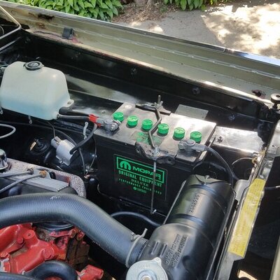

I ordered one of these and it worked out well. I know it's not original and you all know, but how many people can tell this is a Wal Mart battery? I'm not going to tell. Here's a link. They come from Belgium so they take a while to get here. Be patient. They have a good selection of push in and glue on caps in 3 colors and different styles. Check your battery first to make sure they will work.
1/22 Update: there is a embossed "Mopar" side plate available.
https://www.ebay.com/sch/m.html?_ss...12.TRC2.A0.H0.Xmopar.TRS0&_nkw=mopar&_sacat=0
battery topper kit.jpg Battery topper kit3.jpg battery topper kit4.jpg battery topper kit6.jpg

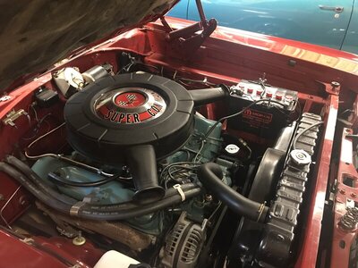

Been running caps for four years now on a battery from Batteries Plus

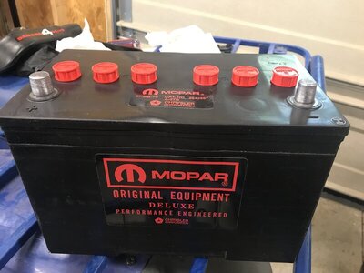

My battery had push in caps (3 caps to a cover) If your battery is a flat top, you will need the glue on caps. Here's a push on cap battery.
