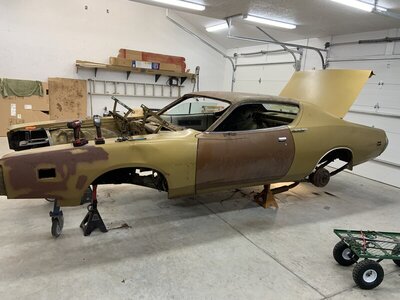

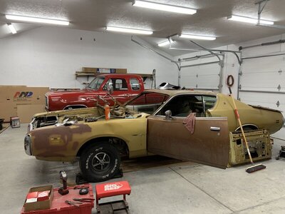

Word was it spun a bearing back in the 80s and the engine removed and taken apart and that's how it sat. Has some damage on the drivers side. The door will be replaced with one off the parts car. The fender will be fixed. Found more rust on the cowl.
I really like the early style pin stripe used so that will get reproduced.

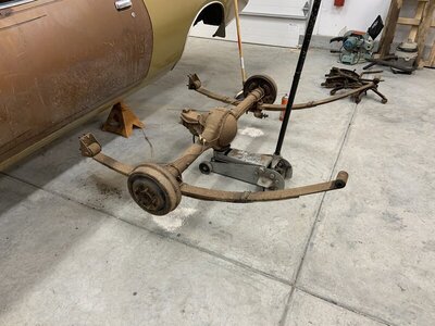

Installed rebuilt door hinged I had stashed away and the new drivers door while loaded. Then the suspension came out and got it on dollies.

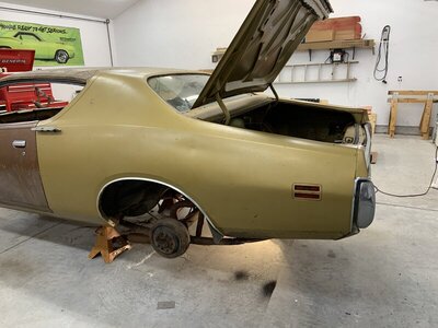

Floors and trunk are clean! but that vinyl top left a mess.

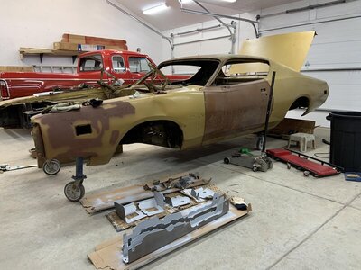

Here it is completely gutted. I measured and drilled the emblem holes for the hood and fitted it. Installed the 4-speed hump and buddy seat brackets, then a good coat of SPI epoxy in the interior and trunk.
