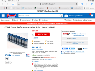

I’ll be using these in my new motor.
https://www.summitracing.com/parts/cca-2901-16

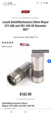

These plain solid lifters are Lunati # 70937-16, smooth sided, No oil band-groove, Non-EDM type, std 3 piece lifters (hollow lifter face-body, Removable pushrod Seat & 0.035" thick flat stamped C-clip/snap ring Retainer. Does Have a pushrod Seat oil entry hole Without any EDM or other oil exit hole & pushrod seat rattles (empty, no oil) with 0.024" verticle clearance within 0.060" inside snap ring groove. Will the .028" lash beat out the internal snap ring ? ... Never seen an oil entry hole on a flat tappet Solid lifter before & don't know it's function ....Anyone know or who makes Lunati solid lifters ? .....tom.
